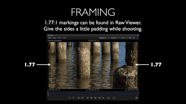

This is something I only really learned when working on a DI for a 4K demo project I shot recently for Canon. The DCP container format is designed to hold a 1.89:1 image, which seems to be a compromise between 2.4:1 (“scope”), 1.85:1 (U.S. widescreen), 1.77:1 (16:9 HD) and 1.66:1 (European widescreen). When shooting 4K or 2K with an FS700 you’ll be looking at a 1.89:1 frame but there are no edge markers to show you were 16:9 cuts off. This wasn’t an issue for the demo that Adam Wilt and I shot for this presentation but it could certainly be a problem when composing frames for a project with really strong compositions.
The Sony raw viewer does have the proper guides, by the way:
CIneGear 2013 Art v4a 015
You just won’t see those while you’re shooting.

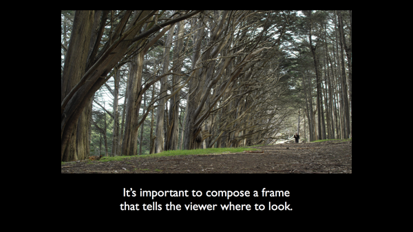

CIneGear 2013 Art v4a 020
This is a roughly graded frame from a project I shot for Canon’s 4K demo reel. Hopefully it’s clear to you how your eye should move through the frame. If not…

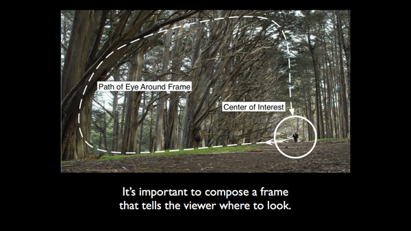

CIneGear 2013 Art v4a 021
…this is what I intended. I used perspective and contrast to start you out looking at the distant figure, and then gave you a path to follow around the frame so you could take in the detail before returning to the figure. In this way I know that you’ll see everything you need to see before the edit, and you don’t have to worry about missing any amazing detail because I’ve given you a path to follow that will take you through the picture in plenty of time before the edit occurs.

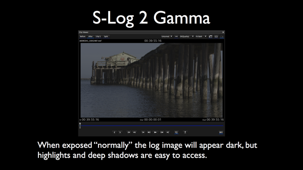

S-Log2 is very, very flat as it’s meant to preserve the most dynamic range in the image and will allow you to see highlight detail very clearly, but it’s not very good at all for judging shadow detail.

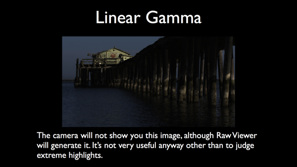

This is what linear gamma-encoded raw looks like. There’s a reason Sony doesn’t let you see this view in the camera: it’s not very useful.

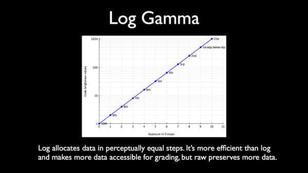

This graph shows the exact same data in the linear graph but encoded in log format, which allocates the same number of data steps to each stop of dynamic range. It’s a very efficient way to store data but it doesn’t allow you to go back later and manipulate the image with new de-Bayering algorithms the way raw does.
Log is basically “lossy compression” as it throws away a lot of highlight detail. The good news is that there’s so freaking much highlight data captured in linear gamma that you can afford to throw it away if you need to. (You just can’t go back later and pull more out of it.)

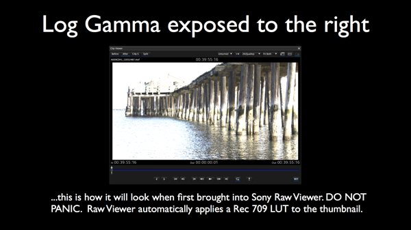

I hate exposing to the right. The result is that every image has it’s own exposure, which results in more work for a colorist as every shot is inconsistent with the rest based on how much highlight detail is in the image. With the FS700, though, it’s really the only way to go as the only exposure reference tools available in the camera are a histogram and zebras. This allows you to expose in such a way that you capture as much of the available image information as possible, but your editor is going to freak out…
CIneGear 2013 Art v4a 033
…because the clip thumbnail shows up like this in Sony raw viewer, which applies a Rec 709 LUT to make the thumbnail look “normal.” Tell your editor not to panic, because you’re doing the colorist a favor.
