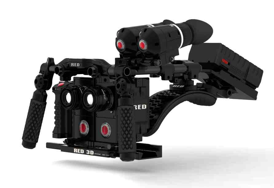

By the way, my idea is to work with two EX1 (or one EX1 & one EX3) mounted on a parallel rig. I have read, that you have this combination. Would you mind to post a picture of your setup? I would appreciate that.
Has anyone heard news about the RED Scarlett 3-D camera, or is it just a marketing gimmick?

Posts: 444
Scarlet when released will be used in Stereo rigs (Just as Red One is already), and will be of a form factor that for landscape and medium distance shots a mirror rig will not be needed (for close up shots a mirror rig may still be needed to get accurate interocular distances, but they will be a lot easier to set up on a mirror rig than the existing RED ONE or some other cameras.)
