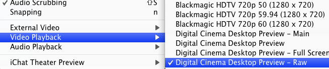

Pavel, is it possible for you select RAW instead of Full Screen in the FCE output?

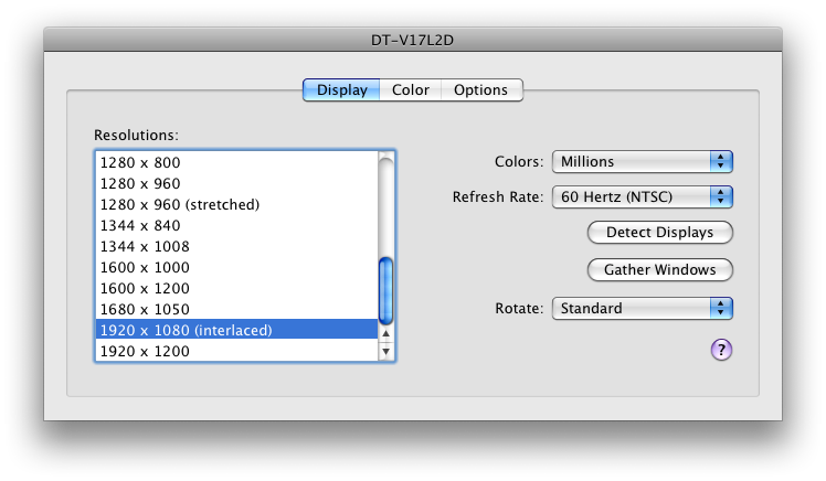

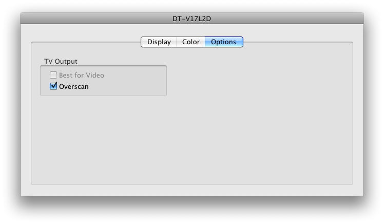

Overscan should definitely be on and you should be able to select 60Hz (or possibly 120Hz) as the sync rate.
Stereo3D Toolbox with FCE-1920x1080-60.png   Stereo3D Toolbox with FCE-overscan_display_settings.png

Tim, the FCE "Video Out" options are: Canvas Playback, Main, Preview and Full screen. No Raw. All the other settings are just like your screen shots.
Pavel Houda is offline   Reply With Quote

Hmmm. I'm concerned that if "full screen" tries to do any scaling at all it will throw off the pattern.
