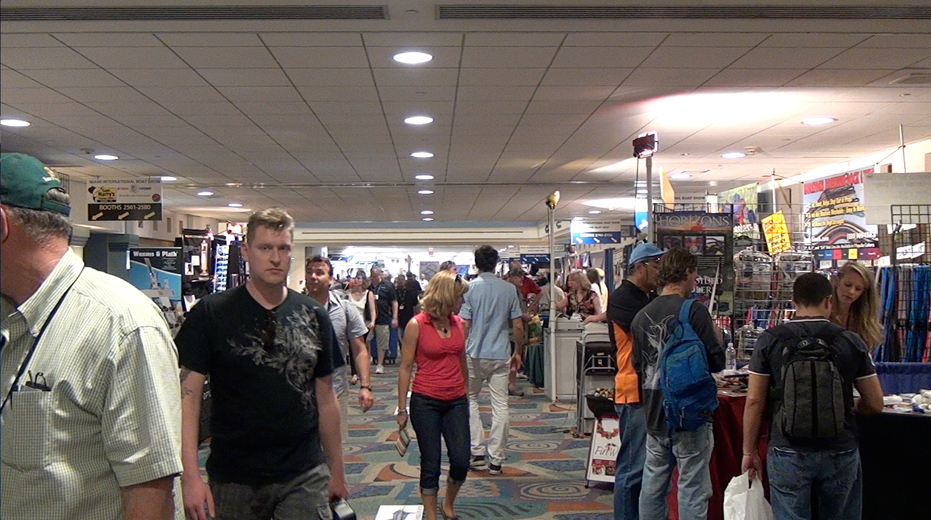

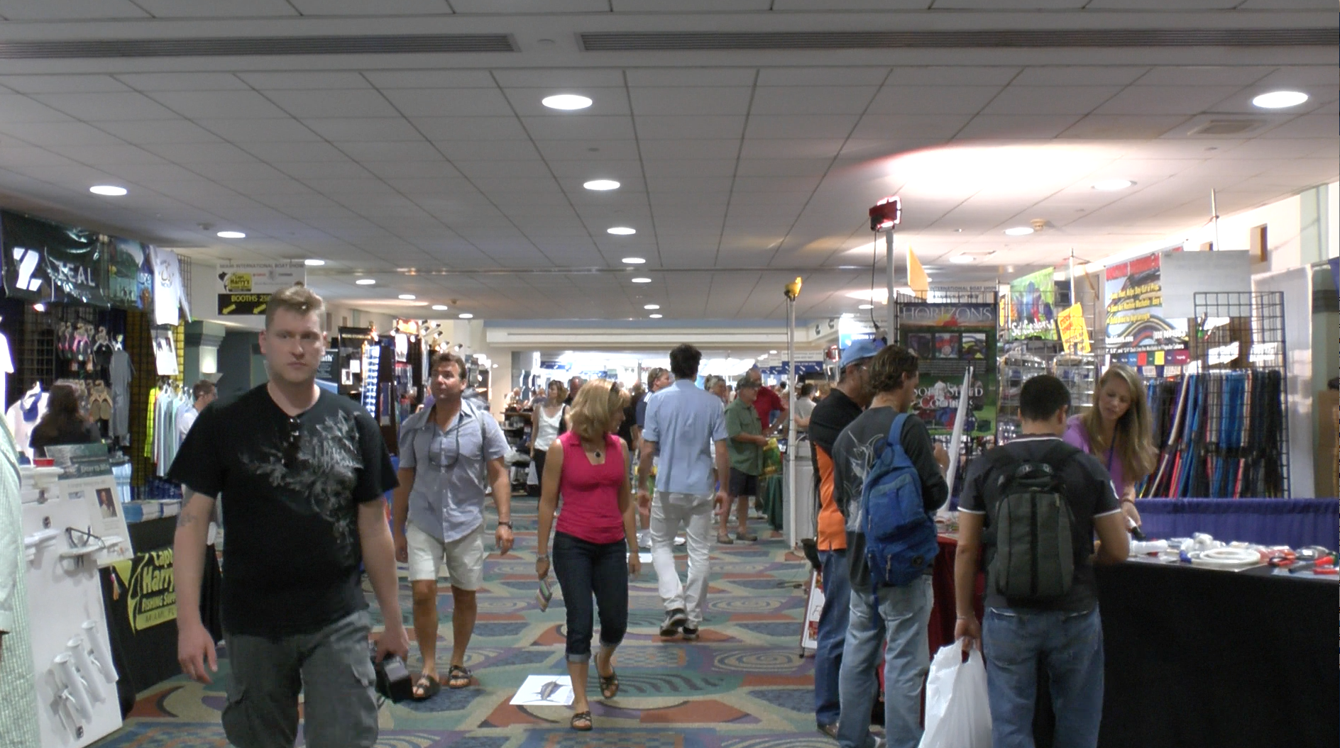

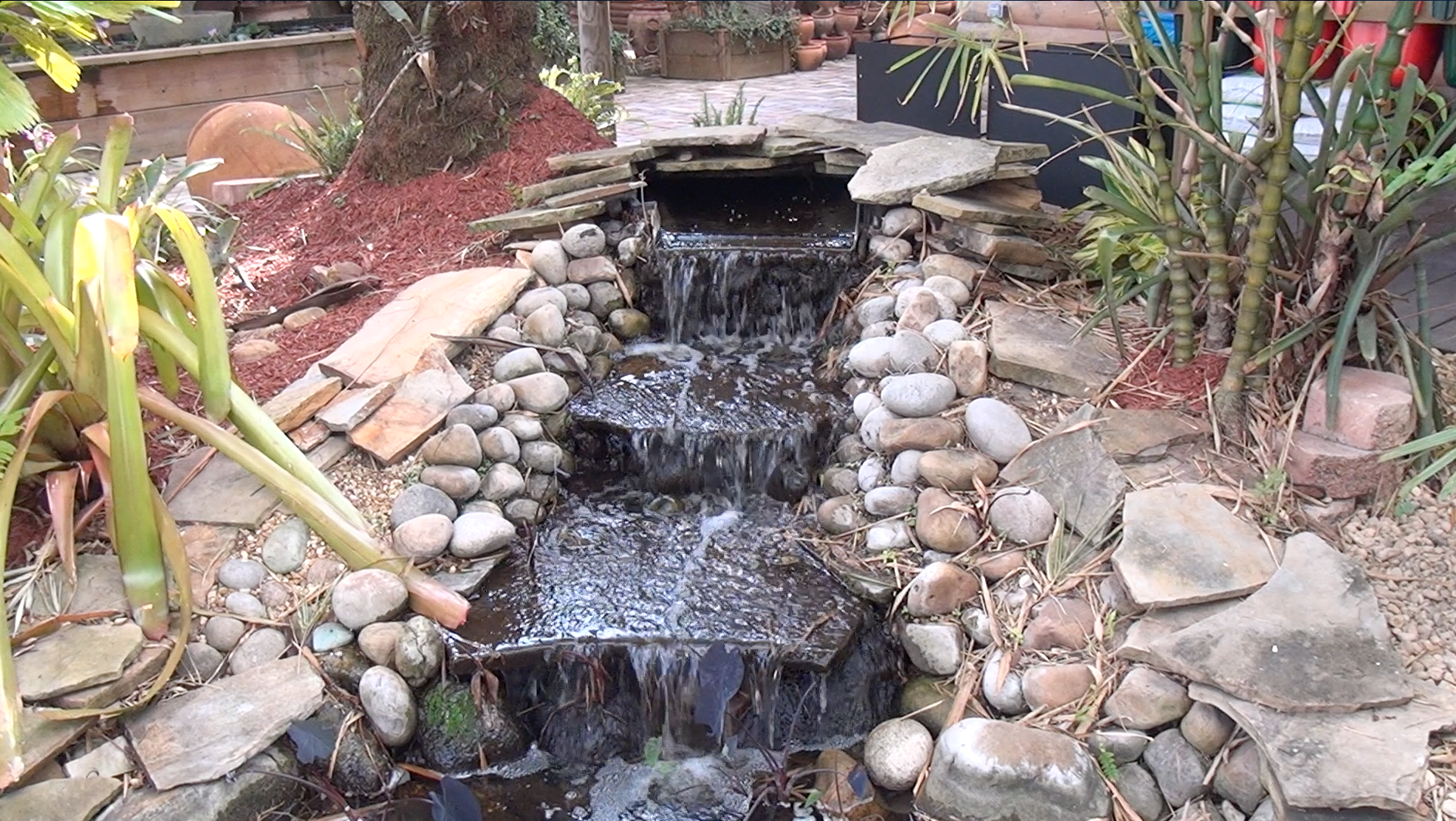

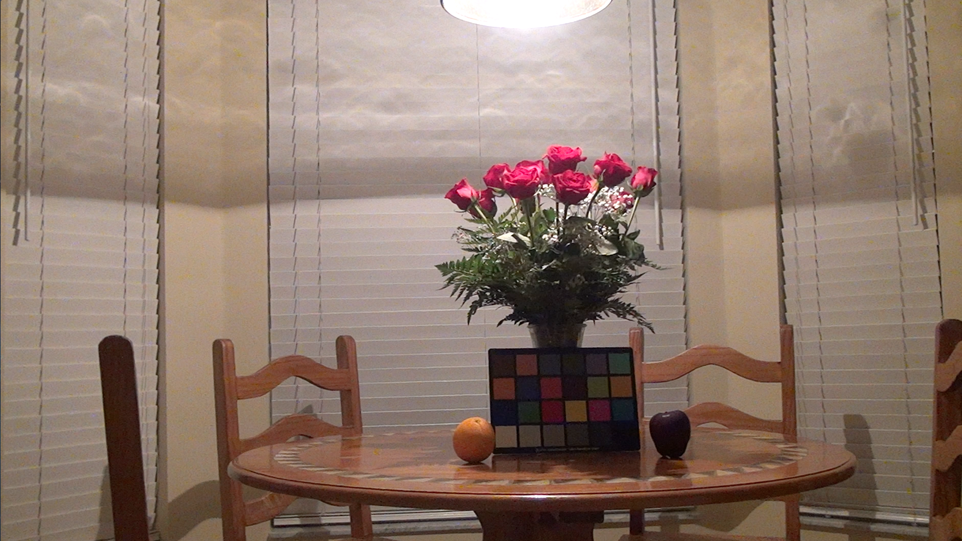

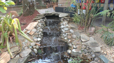

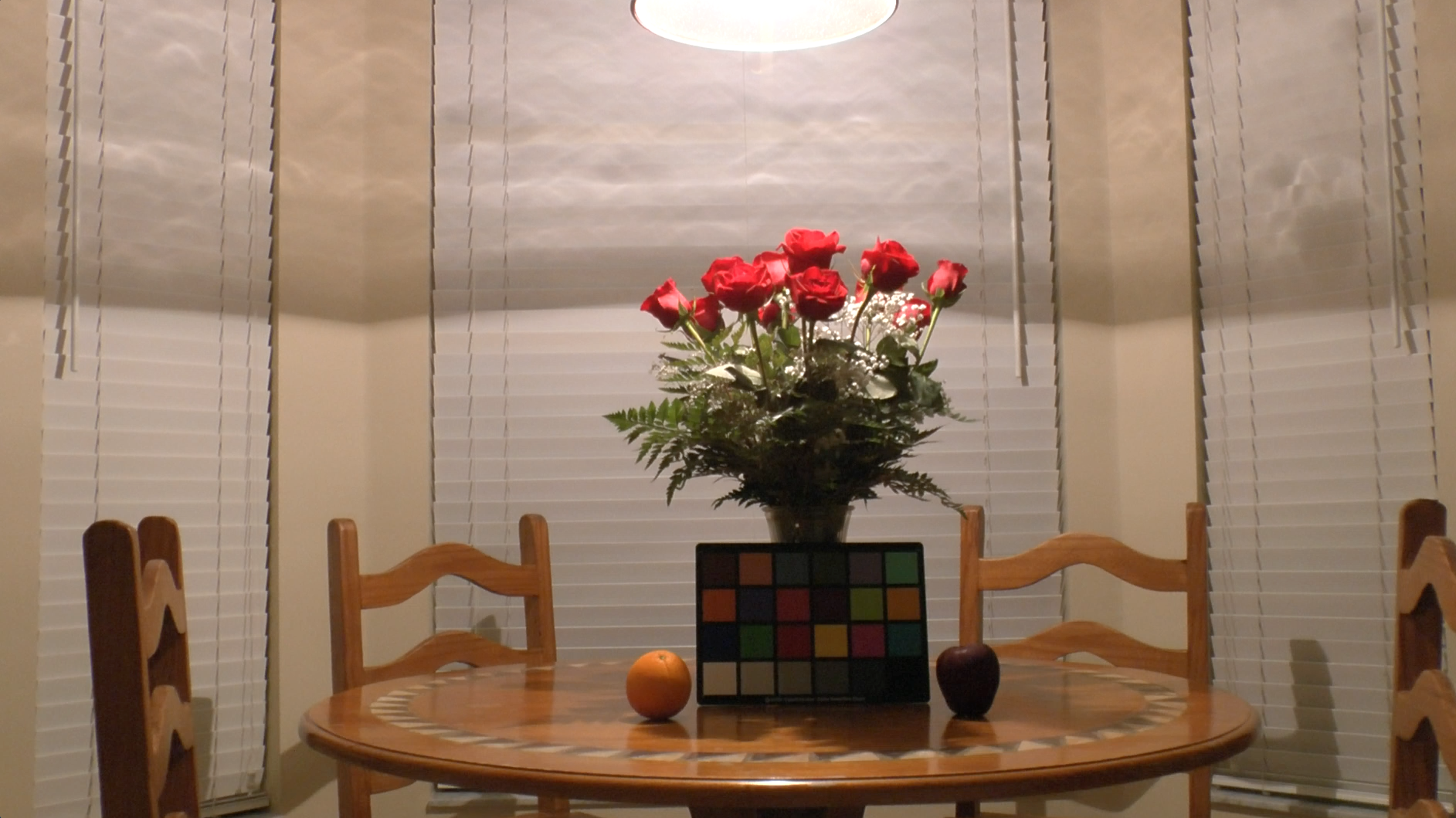

Quick side-by-side testing of Sony HXR-NX3D1 and Panasonic HDC -Z10000
I've managed time to try a few comparative tests of the Sony NX3D1 and Panny Z10K. Cameras were both set for default automatic... no manual adjustments. The Panasonic performs better in low-light, without question. Out of the gate, the Panny is softer than the Sony. I found that turning the noise compensation in the Panny off improved sharpness somewhat - without really adding much noise in low-light. Additionally, I was able to sharpen the Panny footage to match the Sony in post. I do not think the Sony actually resolves more detail than the Panny. All things being equal - I certainly prefer any artificial sharpening to happen AFTER the camera encoder, not before.
Quick side-by-side testing of Sony HXR-NX3D1  and Panasonic HDC -Z10000-panny_table_low.png   Quick side-by-side testing of Sony HXR-NX3D1  and Panasonic HDC -Z10000-sony_table_low.png
Quick side-by-side testing of Sony HXR-NX3D1  and Panasonic HDC -Z10000-panny_tradeshow.png   Quick side-by-side testing of Sony HXR-NX3D1  and Panasonic HDC -Z10000-sony_tradeshow.png
Quick side-by-side testing of Sony HXR-NX3D1  and Panasonic HDC -Z10000-panny_water.png   Quick side-by-side testing of Sony HXR-NX3D1  and Panasonic HDC -Z10000-sonny_water.png

David, I'm assuming the Panny is on the left and the Sony is the right set of pics - correct?
Did you measure the lens interaxial distance with a ruler by chance? If so, what did it measure out to?
Old March 2nd, 2012, 12:19 PM   #3
Join Date: Sep 2009
Location: Ft. Lauderdale, FL
Posts: 154
Re: Quick side-by-side testing of Sony HXR-NX3D1 and Panasonic HDC -Z10000
The thumbnails are named Panny and Sony - you can mouse over to see which one is which.
The Sony has a published I.A. of 31.75mm. The Panny is 42mm

Have you tried to adjust the sharpness in the scene file? The Z10000 does not increase the sharpness automatically as that is done by many other (consumer) camcorder, but offers in the profile both DETAIL LEVEL and V DETAIL LEVEL to do so.
Beside that, sharpness is not everything. The tests that I know show a nice resolution for the Z10000, and the possibility to adjus the gamma curve offers and other parameters are great - and go far beyond what I have seen for most HDV camcorders.

Wow! The difference in sharpness is striking, but as you say, it also sharpens the noise, so I guess it's a trade-off.
I'm curious, too, about the color shift. The Panavision is a lot greener than the Sony, in all three of the lighting situations.

Why are the images odd sizes like 1885x1059 rather than 1920x1080? Were they cropped or rescaled?
