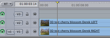

  1. Place the RIGHT side image on V1
  2. Place the LEFT side image on V2

  3. Align the subject by temporarily bringing V2's opacity to 50% and adjusting the x,y position of one or both of the clips. Return V2 clip to 100% opacity.

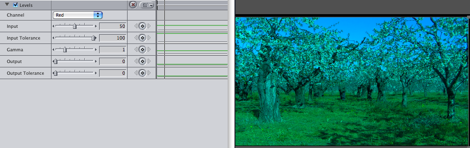

  4. Place the LEVELS filter on V1 RIGHT clip and select RED. Bring the Output and tolerance to 0.
    3D Anaglyph plugin/filter for FCP?-picture-102.png

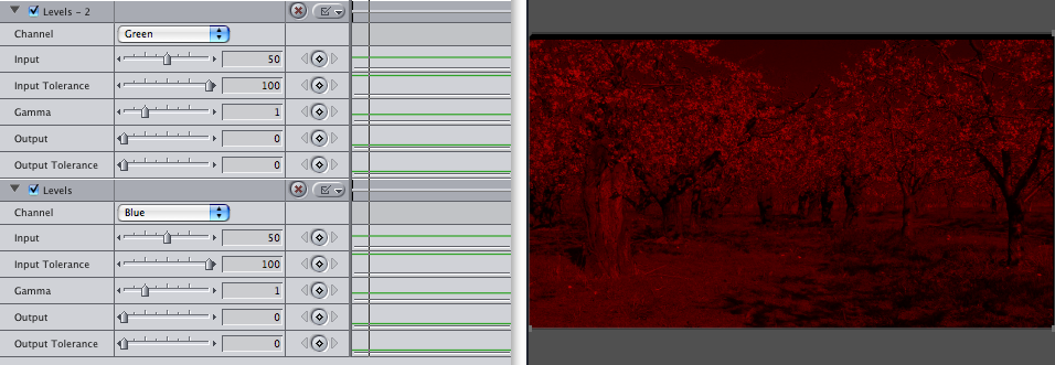

  5. Place the LEVELS filter on V2 LEFT clip and select BLUE. Bring the Output and tolerance to 0.
  6. Place the LEVELS filter on V2 LEFT clip and select GREEN. Bring the Output and tolerance to 0.
    3D Anaglyph plugin/filter for FCP?-picture-103.png

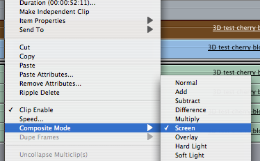

  7. CTRL-click the LEFT clip (V2) and select SCREEN MODE.

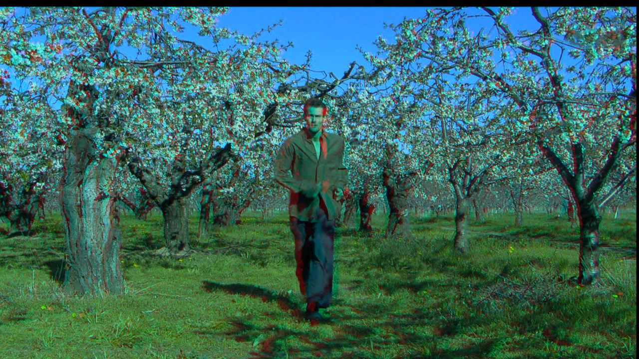

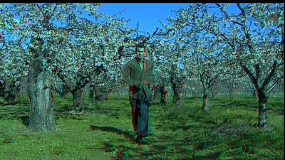

That's it. Now you can copy and paste attributes. I'd still love this to be in plug-in form though.
3D Anaglyph plugin/filter for FCP?-anaglyph-test_fcp.jpg
    Attachment 3637
    Attachment 3634
    Attachment 3635
