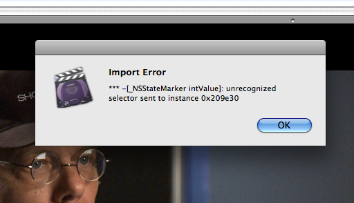

Can somebody point me to the best thread to explain the BPAV folder workflow? I'm getting lost (confused) about when to use the XDCAM EX Clip Browser or the XDCAM Transfer program when I want to bring files into FCP. I'm finding it real difficult to open BPAV's that I've copied onto external HD's.

Thanks so much for the guidance, guys. I guess I've hosed these files up somehow because I'm getting an error message when I try to import them into FCP 6.0.3. Also, I've somehow lost the audio track for this clip as well! And, I'm not sure if it will show or not, but I kept in a small part of my friend's black hat which has the IR problems and shot as a dark brown. I'm sure when my EX1 gets back from Sony Service that the sun will shine again and the birds will sing, but I can't seem to win this week! ;-)
