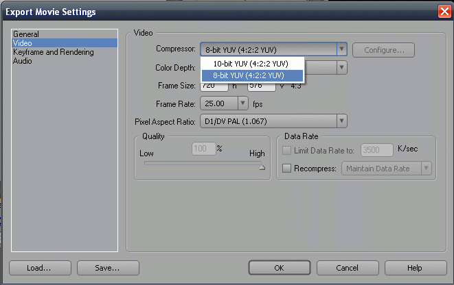

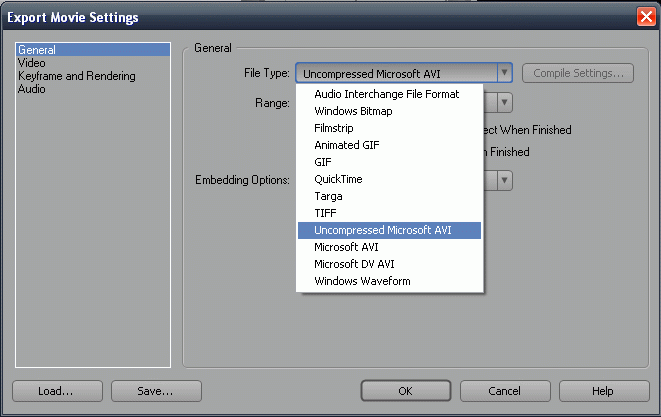

I assume that the uncompressed option in Premiere would be
- 'Uncompressed Microsoft AVI' with '8-bit YUV (4:2:2 YUV) and 'recompress' unticked. Do I need 8 or 10 bit?
Please can you tell me where I find the HUFF YUV in the menu (see screenshots below)?
Alex

huffyuv is a high-quality near-lossless freeware codec that is about half the size of uncompressed (i.e still large!).
I used it a lot until I could afford Cineform, which is much more compact.
You need to manually install the huffyuv codec on your machine (you'll easily find a link via Google). Once it's installed, it will appear alongaside the other available codecs in Premiere's menu.
Edit: Alex .... in your screenshot, your "General" setting should be "Microsoft avi". Within "Video" settings, huffyuv will then show up as one of your "Compressor" options.
Thanks Graham, that makes perfect sense.
