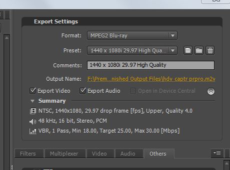

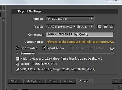

I don't know if it's available in CS3 but if it is (it is in CS4) an option, MPEG2-BluRay in one of the available formats might be closer to your native format.../ Battle Vaughan

Thank you for these helpful responses! I did a little bit more research.
What I am referring to, of course, is outputting a Blu-Ray project which was shot on HDV using the same codec as the source material to avoid transcoding long sequences where there are no transitions or effects. The majority of my work is basic cuts on long sequences of musical performances.
I mistakenly made a reference to exporting in H.264. It is, of course, the MPEG-2 setting which is correct to match material shot in HDV.
What I found was that the default settings for Blu-Ray MPEG-2 medium quality in the export menu of Premier created files which appear not to have been transcoded. I tested these for their similarity to the project codec simply by reimporting them and placing them on the timeline. They did not trigger a red "render indeed" bar above them indicating that they were the same codec as their project resolution. Therefore I believe they match.
The HDV codec from from my Canon XHA1 is 1440 x 1080i 25mps 29.97 fps Constant Bit Rate-the number of pictures in a group equals 12, P-frames occur every three frames
Premieres default settings above are slightly different although the decoder apparently decides not to re-encode. The difference is that those settings call for a variable bit rate one pass process. The average data rate is the same however at 25 MB per second.
My conclusion is that the Blu-Ray medium quality default MPEG-2 settings will export HDV material without transcoding. Any thoughts or comments appreciated
