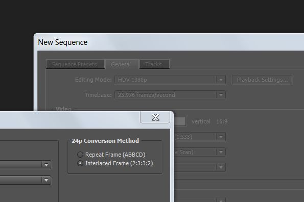

There are two choices for pulldown conversion --- at least in CS4, I assume it's the same in CS5....maybe trying a new sequence with the other choice from the one you are using might help...just a shot in the dark....my PPro defaults to the interlaced solution....

Thanks for the suggestion. It's the same in CS5. I just tried switching from the default Interlaced Frame (same as yours) to Repeat Frame in a new sequence as you suggested and unfortunately, same result on render.
