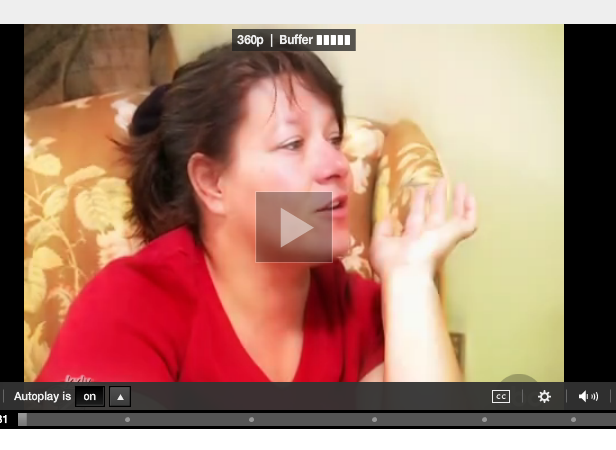

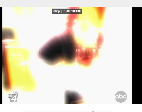

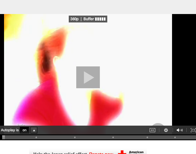

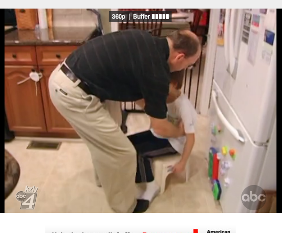

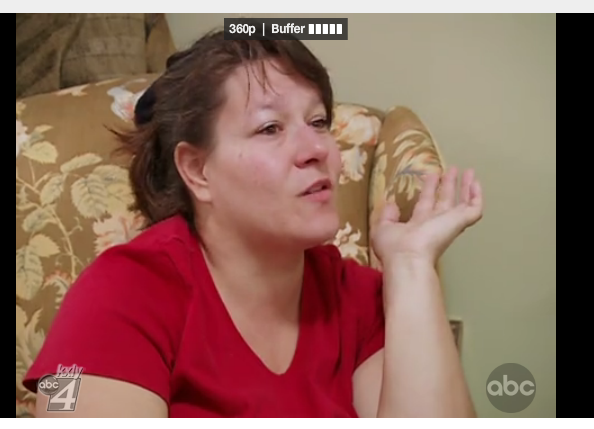

For those who don't want to watch a whole 15 seconds of commercials (or those outside US and Canada who can't watch Hulu), I'm posting some screen grabs, but they don't do the transition the same justice as watching the actual video, but hopefully you can see what I'm talking about in this series of stills.
How to do THIS dissolve in Premiere?-dissolve5.png   How to do THIS dissolve in Premiere?-dissolve6.png
How to do THIS dissolve in Premiere?-dissolve7.png   How to do THIS dissolve in Premiere?-dissolve8.png

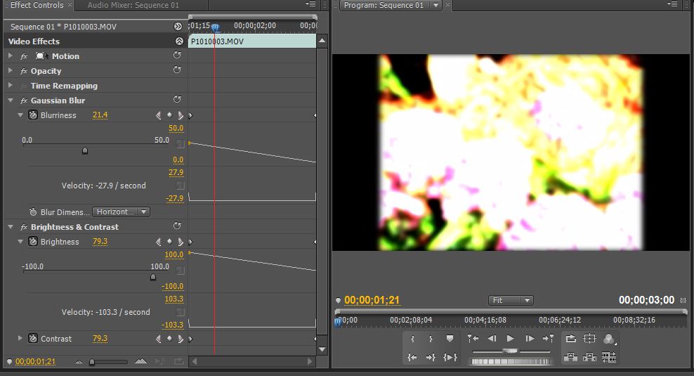

May be doing it the hard way, but I did manage to make a quick dupe of this by doing this:
Razor two butting clips at the points you want the transition to start and end.
In the first clip, apply brightness and contrast keyframing from 0 to 100 for each effect starting at the front of the first subclip and going to the end of the first subclip. Apply Gaussian Blur to suit (maybe 25%) in the same fashion, key frame 0 to 25. You are now mid-point in the transition.
On the second clip, apply brightness and contrast starting at 100 and keyframing to 0 at the end of the clip. (Remember we are talking about a razored clip, this would be the second razored section that is the downhill side of the transition) Likewise start with 25% blur and keyframe to 0 at the end of the transistion clip. Works pretty well and takes much less time to actually do than to describe..btw ...I tried "dip to white" but it didn't work as well....
A very quick and dirty .mov sample attached...the transition probably needs to be longer but I needed to keep the file small....the screen capture shows the setup used in the second clip....the nice part is that, once you have the two effects set up as you like them, you can save them for future use (contol-click the brightness, contrast and blur title bars in the effects window to select them, right click in the window, select Save Preset and give each of the two effects a name, they will show up in your presets menu. I called mine Color Blur In and Color Blur Out....
