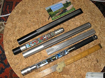

When is an interference tube not an interference tube? The Sanken CS-3e LOOKS like an interference tube mic, and it is....sort of, but unlike traditional interference tube mics, the main capsule is at the tip of the mic and not halfway down the tube or more. Instead there are other capsules below the Sanken CS-3e tip that help it be more directional. As such, the CS-3e does not behave like a traditional interference tube mic with one capsule halfway down the tube.
Ever been inside an interference tube mic? Below is a Sennheiser 416 and Sennheiser NTG-3 out of their skins for everyone to see. The capsule ends up being about halfway down the slotted tube.

Prssure gradient Microphones
Ty, very many thanks for that picture of a 416 separated from its tube. I had vaguely taken in that it was a pressure gradient mic from the literature, but hadn't really devoted much thought to the obvious consequence - that as the diaphragm is exposed to pressure differences existing between both sides of it as the waves pass, therefore the interference tube should be roughly symmetrical on both sides. Never too old to learn.

Well, the real deal is that as directional as interference tube mics are at high frequencies, they are way less directional at mid and low frequencies.
How could they possibly have been used all these years? Historically, there was always someone to yell, "Quiet on the set.", before rolling. That meant there was a set; a space that had been designed (or treated) to reduce sound bounce and that there wasn't much if any other noise around the mic.
