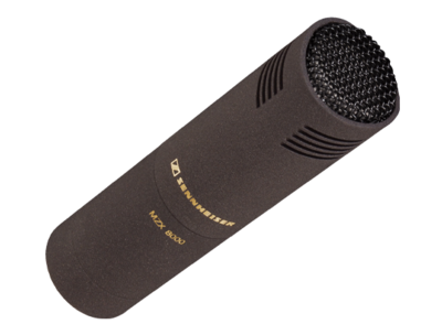

We've been doing a little indoor testing of some of these mics by spinning white noise 360 degrees around the microphone using a jib arm. It's pretty interesting to hear the fall off with the different patterns. The cardioid we tried out is the Sennheiser 8040, the super cardioid is the 8050 and the shotgun is the trusty old MKH-416. The omni is the 8020.
Testing polar patterns video
Guy Cochran
