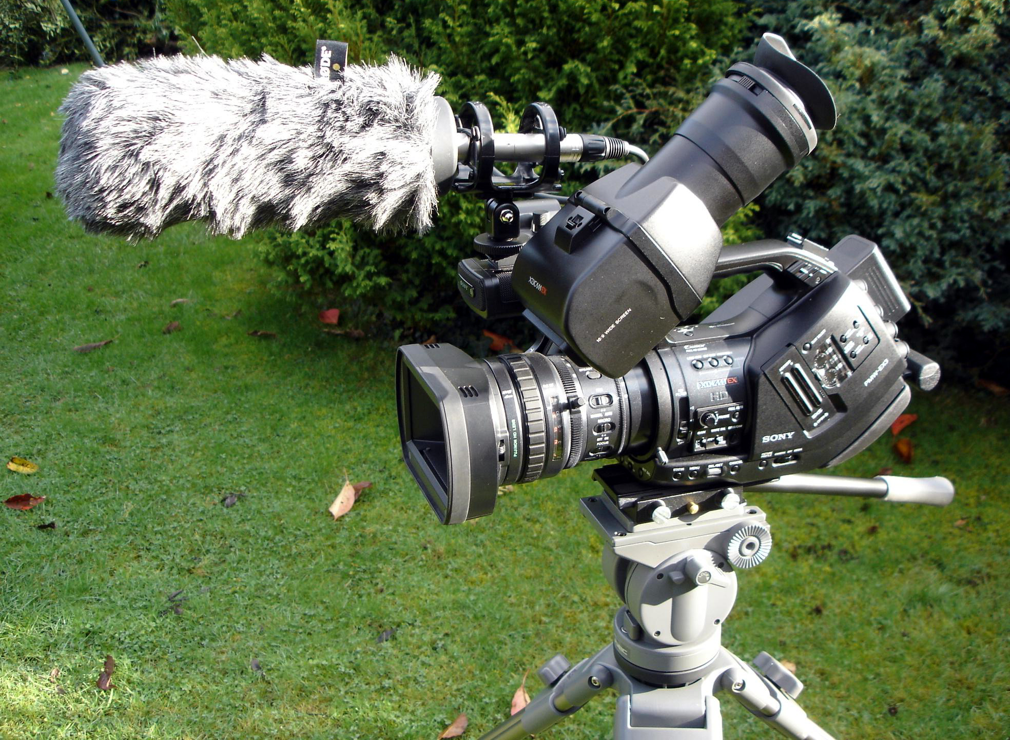

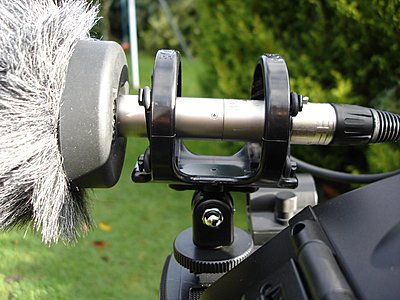

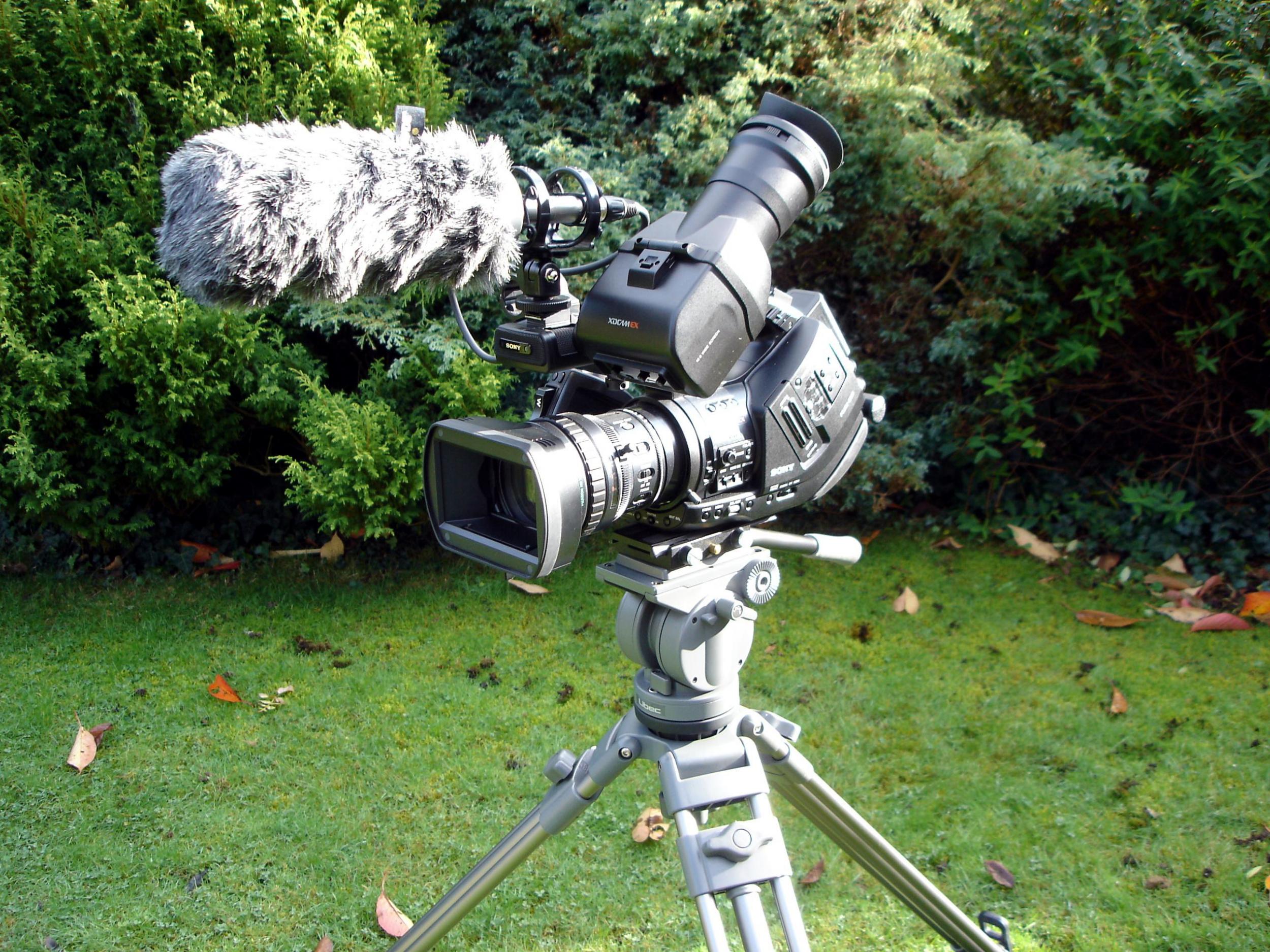

OK, here are some pics.
1st shows close-up of the distance between WS7 and SM3. If you pull the WS7 all the way back it touches the SM3 (not pictured). In the position the WS7 is on this pic there is no obstruction of any vents on the NTG3 and the rear 'O' rings encradle the last 2-3 mm of the mic's body (the plug is a rock solid connection so no worries if the back is supported by the XLR cable plug anyway).
2nd shows 3/4 view - bit over exposed but these were quick grab pics!
3rd shows more of a side view so you can see how far forward the mic/WS7 assembly sits. As I said, the end is still out of shot with full wide...but I suspect would be in shot if I put one of the new Fujinon 0.8X wides on. I'm not that rich yet.....
Mike, you can see I'm taking good care of your old tripod! :-)
Hope this is useful!
