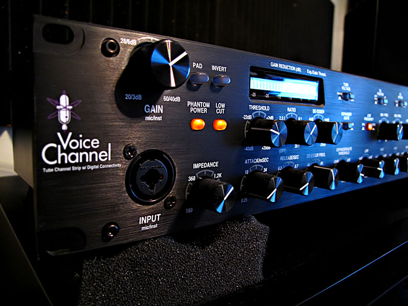

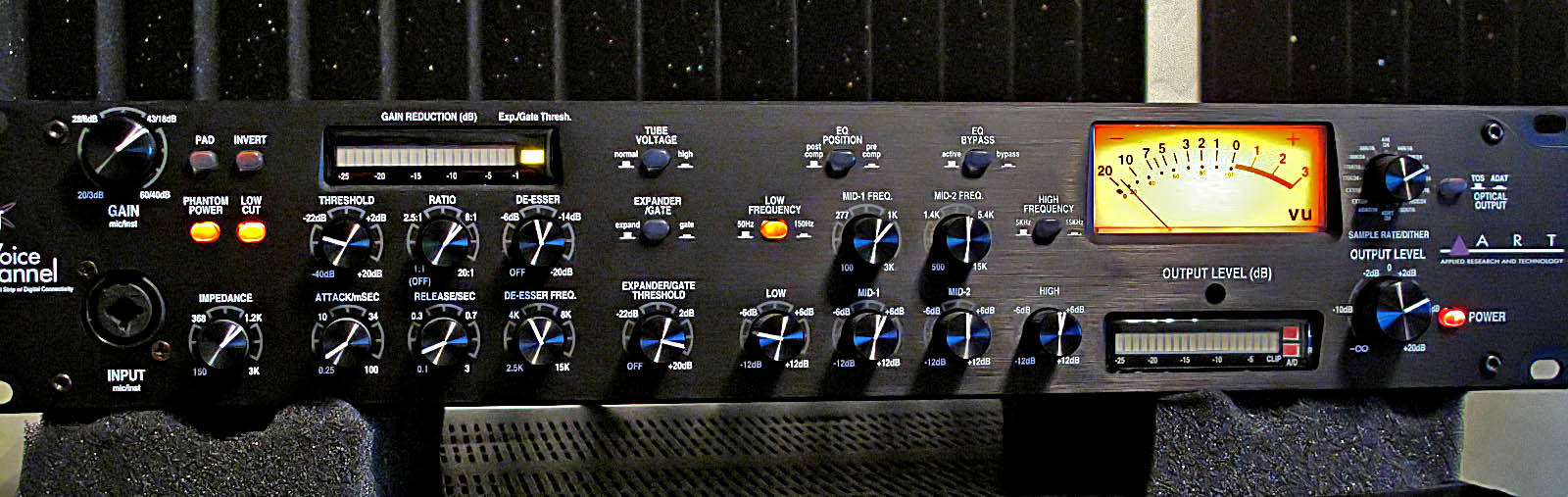

This thread should be moved to the "All Things Audio" as a sticky; this is one of the most timely and to-the-point explanations of how to get good VO tracks that I've seen explained and is spot-on on how to correctly setup voice and musicbed for proper balance.
Also, getting good compressed voice-overs is easily done with the "Voice Channel" from ART. It's a channel strip that can act as a standalone device and has 5 different outputs: XLR, TRS, SPDIF, USB and TOSLINK. It also has a WordClock connection if you use it. The output is amazingly clean, bright and the built-in compellor (compressor/limiter) along with built-in EQ allows you to make the vocals perfect first-time out without having to tweak them later in post. It also won't break the bank.

Robert: that thing is a BEAUTY! When I get relocated and settled in, I may need to invest in one...
