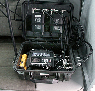

I power my setup with a nano-phosphate battery pack I built using A123 Systems cells. It's the yellow block on the left side of the Pelican case. They're balance-charged with a Cellpro charger. This technology, by the way, comes from the radio-control helicopter industry.
The battery pack also powers a pair of Audio-Technica ATW-1800 wireless receivers for four independent channels of audio. Runs 4 hours at a stretch.

Thanks Dean, I'm looking into these solutions at this point. Today I had a shoot where I had to change the batteries 2 times. It was okay but not that handy since I do not have a proper bag for it so the batt compartment is not that reachable... Since all by equipment is on Sony's V mount batteries i'm thinking of that as a solution.
Dean, what's your further audio setup and what for? The pic is making me curious!

The audio setup is used whenever I go out on boats and cover a few anglers simultaneously. The whole thing can be closed up and remain weatherproof. There's a short two-foot mast that supports four whip antennas. The AT wireless units have proven to be extremely reliable with virtually zero dropouts in the years I've used them.
The camera also has an on-camera mic which provides some backup audio as well as a way of providing a precise sync reference. The camera is set to time-of-day timecode and so is the R-44.
I use SequenceLiner in Final Cut Pro to correlate the hundreds of video clips with the uninterrupted audio clips (the recorder is running constantly). While the initial sync isn't perfect, it isn't hard to manually align them in post, especially if I remember to get a "slate" every so often.
Having the audio recorder running all the time is also very useful in getting those off-the-cuff comments that happen unexpectedly. Especially when a fish gets hooked up. The shouting that happens is one of those dramatic, exciting moments that makes the difference in the final show.
When I made the battery pack I wanted to confirm the proper input voltage range for the R-44. I went through the manual thoroughly and couldn't find the info I needed. After about an hour I looked at the recorder and there was the info I was looking for, right next to the external power port!
