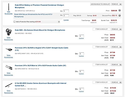

Hi guys,
Being half-deaf audio has never exactly been one of my strong points, but as I'm in the process of putting together my own production kit for the first time (camera, lights, support and audio) I need to organise the sound recording side of things.
For starters I figured a basic shotgun/boom kit would suffice (I'll probably add a lav and wireless lav down the track), but I wanted to run this kit past you guys and check whether it's got everything I'll need (and whether it'll suffice for interviews, commercials and corporate videos).
My plan was to record directly into a Sound Devices PIX240. Will the controls/inputs on that suffice? Or is a separate mixer/pre-amp necessary?
Any thoughts, opinions or suggestions would be much appreciated.

I would forget the Røde shockmount and get the Rycote Universal Camera Kit instead.
The shockmount is vastly superior, it does not droop or bounce, a mini basket windshield and Windjammer is included in the kit as well.
The Rycote Boom Poles are also pretty good at the price and there is a choice of aluminium or carbon fibre ones. The aluminium one is £77,80 +VAT and the carbon fibre one is £150.00 +VAT in the UK.

I've not heard many good things about the ntg2 mic. I'd look at the AT mics like the AT897 in that price range. I'm really happy with my Gitzo carbon fiber GB1540 boompole in the same price range.
The Pearstone isolation mount with the molded rubber parts holds mics much more securely than the rubber-band based ones like that Rode, for about $50. But if you're eventually going to get a blimp, go directly to the Rycote S-series which includes a much better lyre suspension that can be used without the blimp (as well as a handle and pigtail) for $300, and skip the cheaper suspensions.

Thanks guys, I'll look into all those parts.

Well I picked up my basic kit this afternoon. I actually managed to find it cheaper here in Australia than I could get it from B&H (even before including shipping!). I went for the Rode NTG-3 shotgun, with the Rode Blimp, windjammer, 10' boom and a Hosa XLR cable (it all came together in a kit).
Initial tests with the PIX240 I also picked up today seem really promising.
Thanks again for all the advice and suggestions guys.
