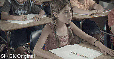

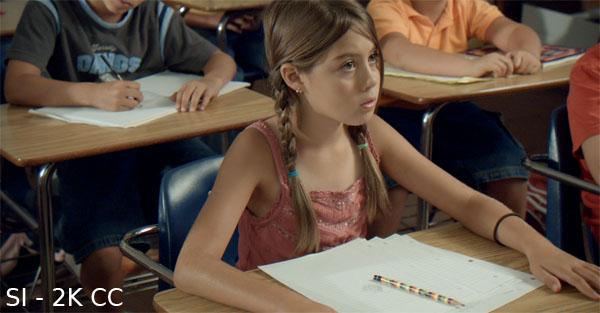

Really all of the original unmodified video that comes from this sensor is desaturated to an extent. If you go to the Silicon Imaging website and download the videos from the gallery you will see for yourself. I would imagine the same thing is true of any CMOS camera including the RED One.
Because of the relatively low signal noise level I believe saturation can be safely adjusted. Based on videos shot with SI-2K this camera should have a lot of potential.
The images below are not mine, they are snapshots from the videos on the Silicon Imaging website. I did a quick CC on one (just brought up the saturation a bit) the other is original. Keep in mind they are 70% compressed JPG.
Sumix 2/3" 1920x1080 CMOS-si2kcc.jpg   Sumix 2/3" 1920x1080 CMOS-si2koriginal.jpg
