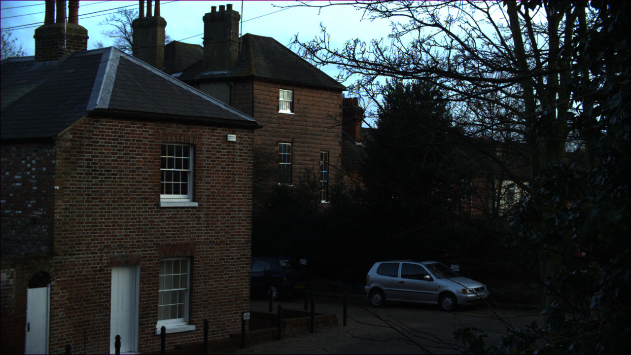

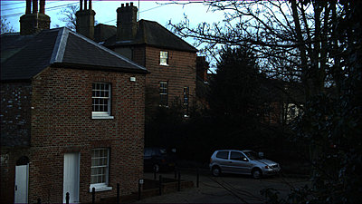

I've dug out a sample of what i mean (my first attempt at uploading images as well...)
the uncorrected image is basically linear result from the sensor and all the information we're interested in is in the shadows. These were 16bit RAW bayered images, debayered (badly!) into 16bit RGB tiffs and then in AE use the cineon Linear to Log for a quick and dirty conversion, some CC tweaks and then output back to 8bit.
Highlights are protected (see the window, top middle) yet there is good range in the shadows, the colours are pretty accurate for the day. The colour sparkling around the branches is just a result of the simple bilinear debayer. They were originally 1080p but i resized them for here.
Lens was a fujinon 25mm f1.4 however that's nor fair because it was a 2/3rds lens and the image circle barely covered this sensor (which was 1"), the edge performance is soft but that's the reason.
I hope the images look okay, my main workstation is calibrated but this laptop isn't and they look too wishy washy on here...
hope this helps...

Sumix 2/3" 1920x1080 CMOS-window_raw.jpg   Sumix 2/3" 1920x1080 CMOS-window_corrected_1.jpg

Thomas, Im just attempting to show the kind of image that comes directly off the sensor. Im concious that this is a summix thread and don't want to pollute it too much. Also light works logarithmically, so a sky is many orders of magnitutude brighter than a skin tone and being able to capture both is fundemental to all cameras. Even in your consumer cams the sensor is probably pulling 12bit off the sensor it's just that the AD converters and compression result in 8 bit HDV files simply because it's easier to transport.
But the dark image is closer to what the sensor sees and once you get RAW from the sensor that could be what it looks like. However in summix case they are sensibly applying a LUT or Gamma adjustment so that the dark image is processed a bit and you can see into the shadows. But a LUT should be more than a gamma curve and you'd want to change it for different situations. It would be nice though to be able to flag or mark certain exposure areas on the display - i've always fancied a zone system with false colours overlaid.
However one of the appealing things about these DIY cameras is that you do have control over everything so i would personally want control over the type of lookup in the camera or have the frames RAW. I hope that with summix you can.
I hope that makes sense. You'll only be able to judge the performance of the summix once RAW output is enabled, but it should be good. However none of these camera are magical!
