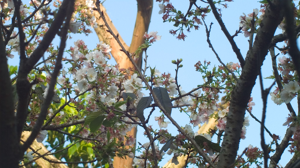

Here are some more random shots I put together. I've upload it on to Vimeo:
SMX12A2C Test Shots on Vimeo
Please download and watch the original AVI file(~80MB). Even that one is highly compressed and has some compression artifacts not in the uncompressed files.
There are indeed aliasing issues. You can see them in the wide-angle shots (e.g. the building on the upper-right of the 4th shot) where the lens' resolution appears to be higher than the sensor's. I think an OLPF is needed.

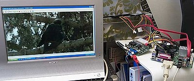

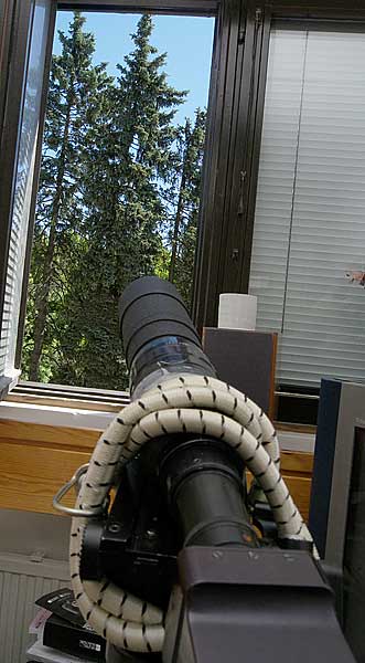

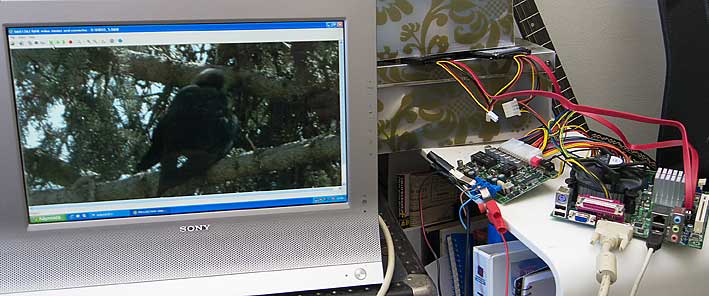

Okay, I got that video project PC ... so my first quick test shot of jackdaw with sumix + 300mm telecentry ... here is link to video :D
Index of /sumix
Original was 3.3Giga... and packed from VLC is 5.9mb
I dont have any other videosoft at my "PC" than, what came with a sumixsoft and it's very difficult to handle. My all videosofts are at my mac, FCP, AE, Color...
So I export avi and moved it to my mac, but only program what showed it was VLC player,
so I was not able to adjust anything. I tried to find wraw to quicktime, but
no succes ...
and few picts of my quick assemble bare-pc. I just wanted to try is system working.

Hello Johanes,
Sorry for the late reply.
That's a long lens you have there. Your system looks promising. Great footage, too.
There seems to be some transcoding problem of the footage. The resolution seems to be only half of the original.
The program I wrote saves the raw data in DNG sequence directly. DNG sequence can be opened as footages in Adobe AE, plus the varies adjustment you get with Adobe Camera Raw. I don't think there's any program out there that can convert Sumix's raw format to DNG. The only other software I know that support the SMX-12A2 camera is Norpix's SteamPix, but I've never used it. Currently I don't have any plan to sell my program. It's far from commercial quality anyway.
Do you have trouble connecting the camera? I usually have to redo the connecting procedure 2 or 3 times before it succeeded.
