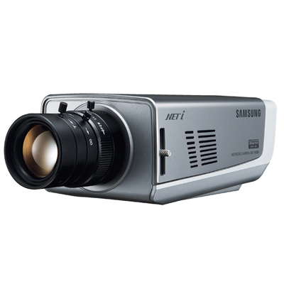

just wondered if anyone had thoughts on this camera as a 720P CAPTURE WITH A LAPTOP...
GVI Security SNC-M300 3 Mega Pixel MPEG-4 and JPEG Motion Streaming Color Camera at Markertek.com
The SNC-M300 is a high resolution color network camera that comes equipped with a 3 mega pixel CMOS chip that is capable of progressive QXGA (Quad eExtended Graphics Array) scanning. The camera has a maximum resolution of 2048 x 1536 and comes equipped with a SD card slot for on-alarm event recording retrievable over the network.

It looks like an interesting device, here are a few thoughts:
What is Video Quality: Very High?
Frame Rate: 25, 19, 13, 12, 10, 6, 3,
Why not 24?
Resolution: 3 Mega 2048 x 1536
Ok so it's a 4:3 Sensor, but can it also do 16:9 windowing?
There is very little info about how the internal camera parameters like exposure time, white balance, etc are handled.
As Oscar mentioned, this camera is not as powerful as an Elphel at around the same price level.
Sebastian Pichelhofer is offline   Reply With Quote
