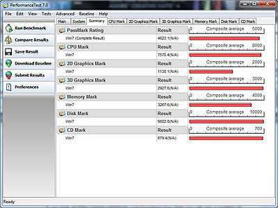

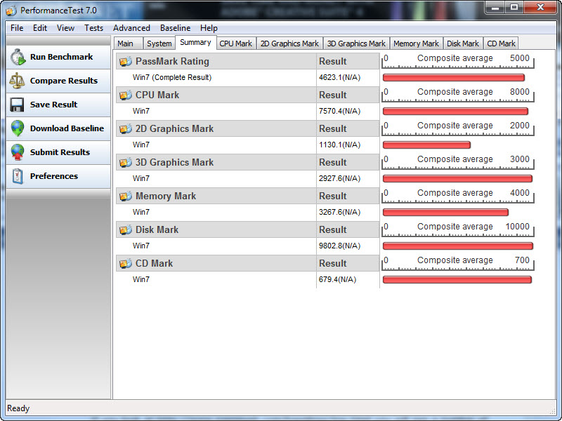

BTW, I'm still waiting for the Top 20 list to be updated with my latest Win7 results (BL#106949). When that happens, I will have rank #1 with Vista (score 6055), #9 with Win7 (score 4623) at much lower clock speed (3.44 GHz), and the current score of 4300, now at #15, but then dropping down to #16.
And yes, Win7 is around 10% faster than Vista in these tests.
