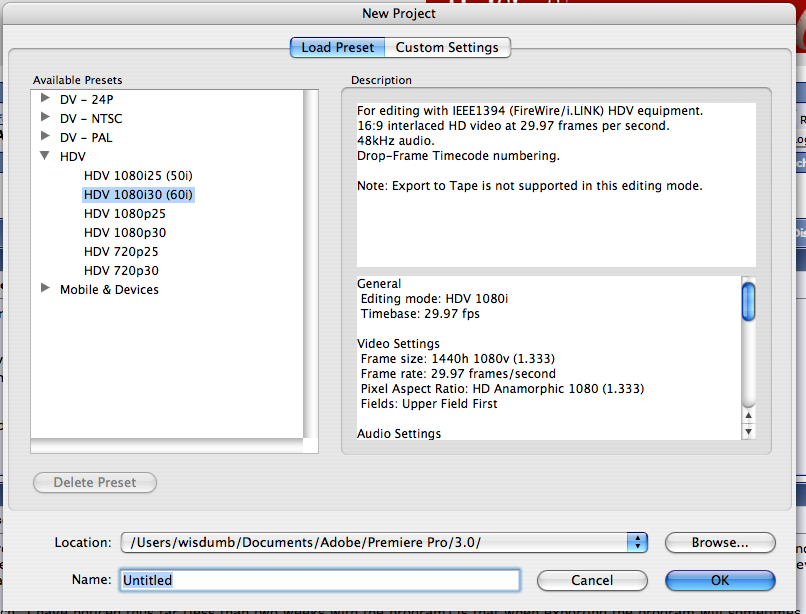

Old August 7th, 2007, 11:17 PM   #86
Location: United States
Posts: 3
No initial preset, but....
There is no initial preset for 24fps in HDV, but it correctly interprets the footage as 23.976fps and you can export to 24fps. There is a preset for 25fps that may reduce render times... I'll check it out and let you know. I have not had any problems yet, but I have only exported short clips. 60i works fine also.
I have attached a screen cap of the preset dialog at startup as an FYI.
Fredrick Irvine is offline   Reply With Quote
Old August 7th, 2007, 11:19 PM   #87
Posts: 3
Oops, and now for the Screen Cap
Forgot to upload...
