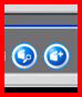

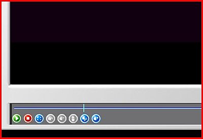

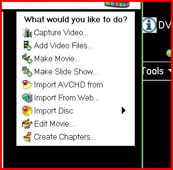

Old December 4th, 2008, 09:19 PM   #161
Location: Eggertsville, NY
Posts: 497
Originally Posted by Mike Burgess View Post
Hey Larry, how do you make chapters in Nero. The manual from on line says to go to the contents screen and highlight the video title. Does highlight mean to click on it so that you go to your saved project?
And then it says on the (it shows a small movie time placard), click on the "add chapter" button. Where is this placard? I see no add chapter button.
Can you give me an easier method of creating chapters in a project on Nero?
Mike
Mike,
This is very conventional. You chose "Create Chapters" from the menu I have attached as the first jpeg below, and once the new screen appears, you then either:
scrub the timeline manually and add chapters using the left green button shown in the 2nd jpeg
or
scan the time line automatically to detect scene changes / add chapters using the right green button.
Larry
Burning AVCH Disks Please Help!!-create-chapters-menu.jpg   Burning AVCH Disks Please Help!!-auto-manual-chapter-create-buttons.jpg

Old December 4th, 2008, 09:26 PM   #162
Posts: 497
Better view of chapter add buttons
