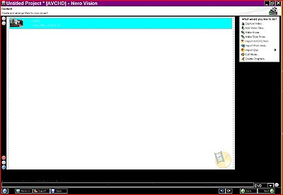

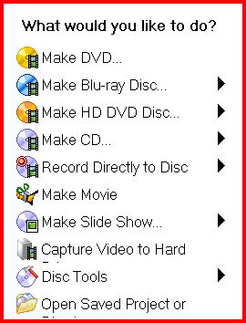

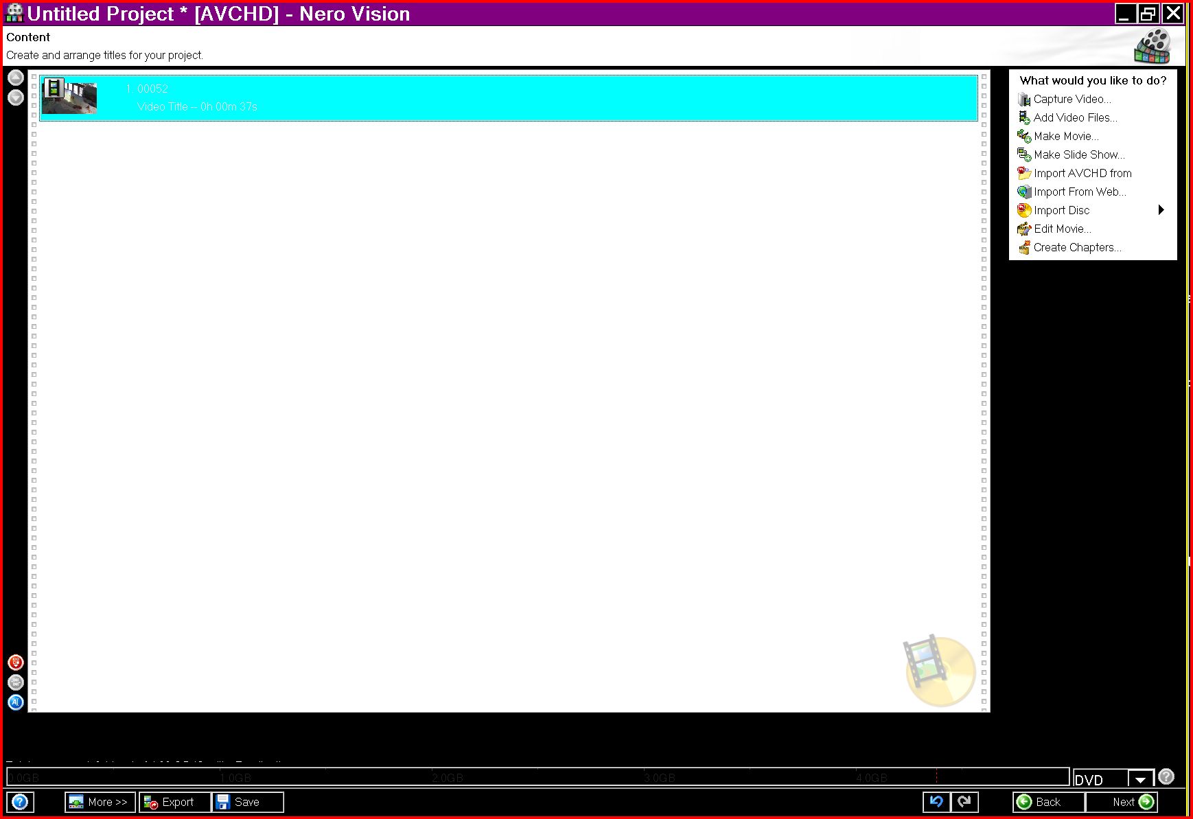

Mike,
When Nero is started / launched, the first screen allows you to chose Make DVD-->AVCHD.
When the next screen appears, I see the following image as shown in the first attached jpeg. At this screen, the Make Chapter item at the bottom of the list is present but grayed out.
If I then select and open a video file, the Add Chapters item is no longer grayed out and allows chaptering.
Have you purchased and installed the optional $20 HD pack for Nero. If so, it does not appear to be activated.
If it were activated, the menu you provided to me should look like the 2nd attached file below.
Larry

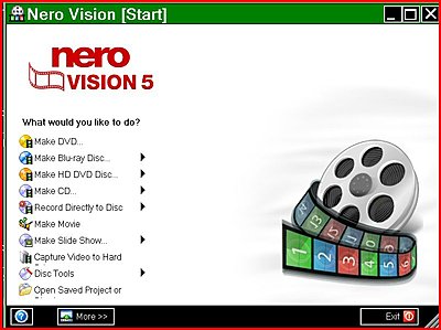

Mike,
This is my very first initial screen of Nero Vision 5. Is yours different?

Originally Posted by Larry Horwitz View Post
Mike,
Yes. It does not have Make Blu-ray Disc, Make HD DVD Disc.
Mike
