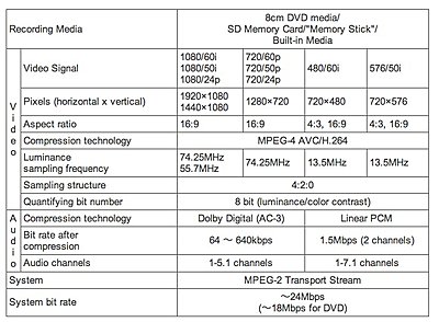

1) See attached pix for the specs for AVCHD. This chart was published widely in Japan and later in the USA.
2) Canon Japan has a new posting on MXP (24Mbps) mode, the DW-100, and AVCHD compatibility"
"Our company home page and the digital video camera comprehensive catalog (2008 July edition) page 6 page /11 page /13 page /18 page /24 placing on page /28, and page 7 of saddle stitch,
the MXP mode “of iVIS HF11” “iVIS HG21” (approximately 24Mbps) with the image which is recorded, at DW-100 we guided [to] the effect which is retention possible,
but the function where as for the disk which is retained because there is NO compatibility of the equipment of AVCHD standard
correspondence of marketing, that it is not unable to
cause confusion to the customer, it judges, uses DW-100 and retains the image of MXP mode in the disk faultTo make on-board. Doing to apologize, we correct.
Furthermore, as for the image which is recorded with MXP mode, to the software “ImageMixer 3 SE which” belongs “iVIS HF11” “iVIS HG21” is used, it is retention possible in the hard disk of the blue ray disk and the personal computer.
The product catalog which presently it is open is something of the correction being completed.
3) This long statement replaces the simple statement I read and posted here a month ago.
4) The current materials on the DW-100 do not include information on MXP, so that's the reason you didn't find any limiting statement. See photo of the manual -- you'll see it is PRE MXP.

Your attachment and citation is for a small 8 cm "mini-DVD" of the type used inside a (very) few DVD-based AVCHD camcorders such as the one I cited earlier (the Panasonic HDC-DV1). Most AVCHD camcorders do not use an internal DVD recorder, but rather use either a hard disk or solid state memory / flash cards, all of which are not at all limited by write speeds like a mini-DVD drive.
(In fact, my TX-1 Canon HD camera, which uses relatively uncompressed MJPEG HD video, uses a Class 6 flash memory card which is several times faster than an AVCHD camcorder ever could write or read.) Hard-disk based AVCHD camcorders are not limited in this 18 Mbit/sec manner either.
This is *****not a***** spec for an AVCHD of the standard 12 cm size, the type produced by conventional DVD burners. It is a mini-DVD recording spec for 8 cm disks which are inherently slower.
Clearly AVCHD camcorders already announced at 24 Mbits/sec would entirely violate this spec if it were, as you had indicated, a spec for AVCHD itself.
Also note that the "spec" page you attached clearly shows an "approximate" symbol, which engineers use all the time, which looks like this squiggle " ~ ", indicating that even the 8 cm camcorder mini-DVD recording spec is not fixed at 18 Mbits/sec, but instead is approximate.
Larry

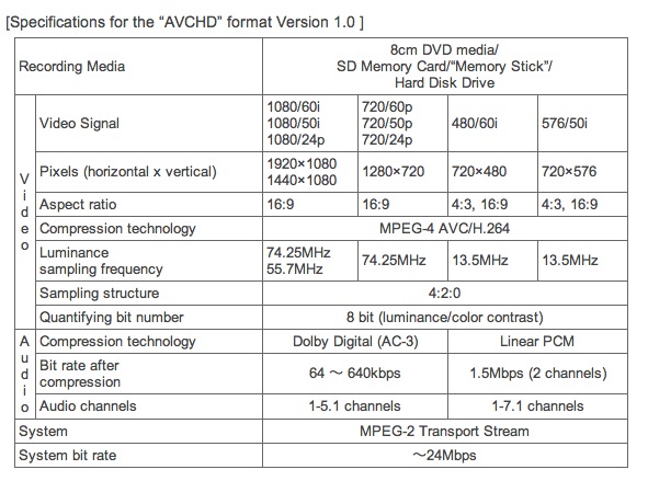

The " ~ " means "roughly similar" which is the correct statement because the recording is VBR. It does not mean you are free to burn at any rate you want. See how Panasonic describes its ~21Mbps.
HOWEVER, there has been a revision to the AVCHD specs -- although it still doesn't specifically mention 12cm DVDs.
"The two companies have decided to include memory cards (SD Memory Card and Memory Stick) and hard disk drives as applicable recording media of the format in addition to previously-announced 8cm DVD. This is for the purpose of broadening the range of applicable media, thereby allowing wide variety of products to be developed by various manufacturers. The new specification was defined as “AVCHD” format Version 1.0."
AVCHD INFORMATION WEB SITE
This clearly indicates the SIZE of the DVD had nothing at all to do with the 18Mbps limit. In the new spec. every media SHOULD support 24Mbps and every BD player SHOULD be able to play 24Mbps. Should doesn't mean will. :)
However, Smart GOP editors will get you 24Mbps ONLY IF you own a new Canon. And, right now it looks like the old limit of 18Mbps is the maximum one can choose with other burning software. Hopefully that limit will be raised to 24Mbps ASAP.

The "~" can indeed be used in geometry to represent similarity, but its common interpretation to engineers is to mean "approximately", and both essentially mean the same thing in the context of our discussion, namely, that 18 Nbit/sec is not a hard limit. I entirely agree that it does not grant any permission to record at any arbitrary rate you wish, and such was never my claim.
If you are arguing that the brief period of finalization of the basic ADVHD spec between May and July of 2006 is the foundation of your claimed 18 Mbit/sec AVCHD upper limit, and that an (apoproximately) 18 Mbit/sec camcorder recording media limit existed for those 2 months until the actual "Version 1" specification was released in July 2006, I will agree entirely. Isn't it then ridiculous to cite 18 Mbit/sec limits presently? Particularly since the stated limit was only imposed on 8 cm camera recording media? As I stated in an earlier thread, I easily burn and then smoothly play 24 Mbit/sec AVCHD disks here using AVCHD recorded content.
