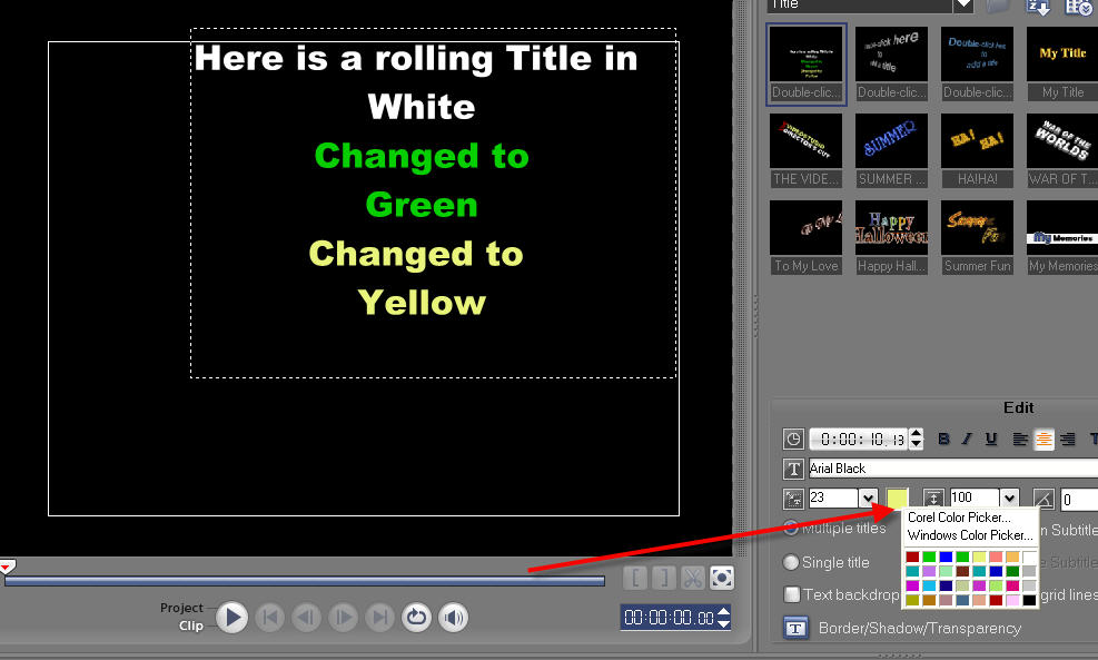

Thanks. Well, my trial period ran out, so I will have to wait until I purchase the Corel program to try the fade. Overall, I do like the program, but I miss some of the things that Pinnacle 12 can do, or should I say, how they do certain things. But, the final PQ is what I am after, so Pinnacle will be put on the back burner, so to speak. Christmas is coming so I will not have to wait too long.
One thing I never did figure out was how to make the titles a different color than white.
Hi Mike,
Any application can be troublesome if you don't use it often. VideoStudio is no exception.
In the Title options, next to font size, is the color options. Select it for color you wish.
It's worth noting that you can have more than one font and color in the same title - a cool option for such an inexpensive NLE.
BTW, you can make your own custom titles, too, and add them to the titles menu for later repeated use.
My best.
Mike
