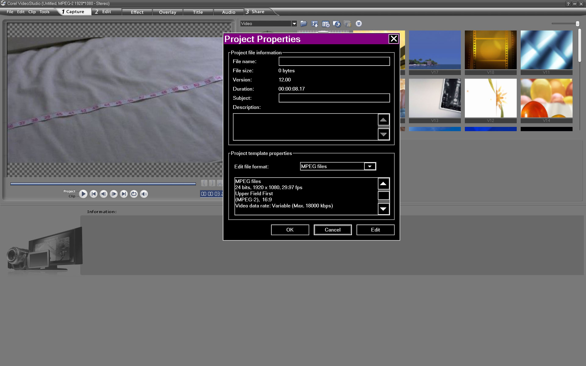

I have downloaded the files and confirmed the glitch you reported. It is quite possible that you have VideoStudio set for non AVCHD projects and thus a transcoding is required as the file is first converted from AVCHD into the VideoStudio project format and then once again transcoded as it is being output as AVCHD.
I have attached a screen shot showing you how the Project Properties need to be set, namely, the same as AVCHD from your camccorder. I can't tell you why Corel doesn't set this as a default or retain it once it has been set from one project to the next, since many people are now using AVCHD. Instead, it defaults to standard 720 by 480 DVD format.
The settings may be the reason for your problem but I am not entirely sure, as I am not an expert in this program.
