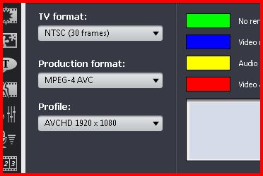

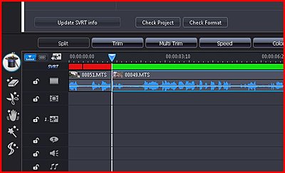

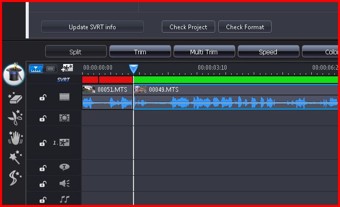

Hi Juan,
It appears that the SVRT feature is always on, and I do not know of a switch you need to use to enable it.
You can show SVRT info by choosing the VIEW Menu and then selecting the SVRT info choice.
If SVRT is available for a specific clip, it has a green bar above it in the time line. If not, it has different color bars depending on whether video and audio re-rendering is required.
I have attached 2 screen clips which show:
1. The proper setting of the SVRT info panel to show AVCHD 1920 by 1080 HD SVRT
2. the SVRT time line with one clip in red and the other in green, showing the first will be re-rendered and the second will not.
I assume you are using AVCHD format video.
Be sure you are using the latest 2.2.2.7.c. release of Power Director 7 Ultra. Earlier versions do not provide SVRT for AVCHD. Cyberlink did not officially admit it was absent in the prior version nor did it advertise the fact that it was added for 2.2.2.7.c.
Hope this helps you,
Larry

Thanks Larry,
I can tell by the first screen shot that the TRIAL version of PD 7 does NOT include the AVCHD 1920X1080 profile. I did create a custom profile, but it's not added to the SVRT info panel, therefore no smart rendering present. In conclusion, you need to buy the full version to see SVRT working (what a shame cyberlink!)
