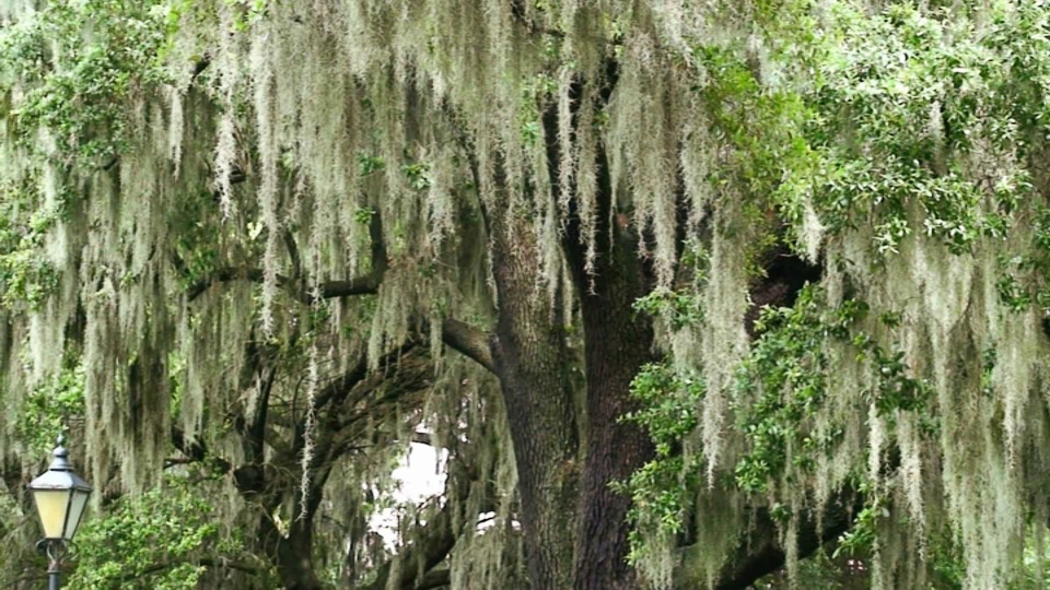

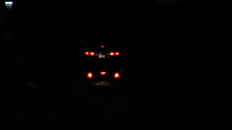

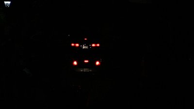

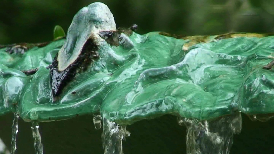

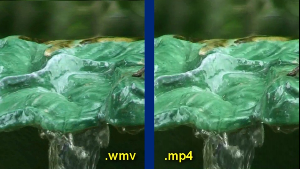

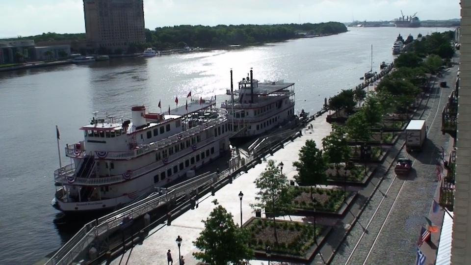

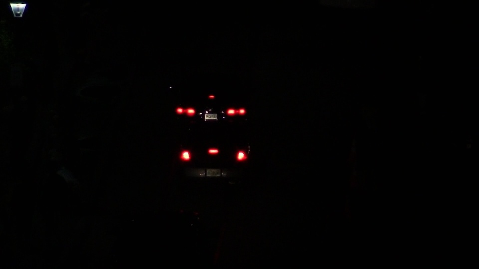

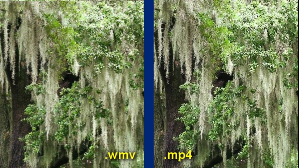

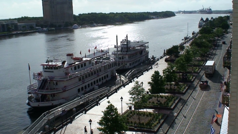

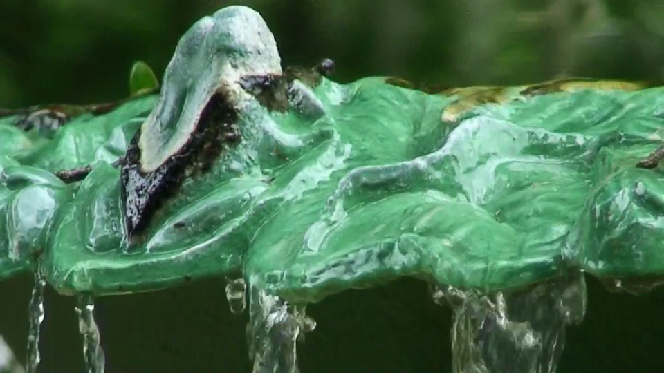

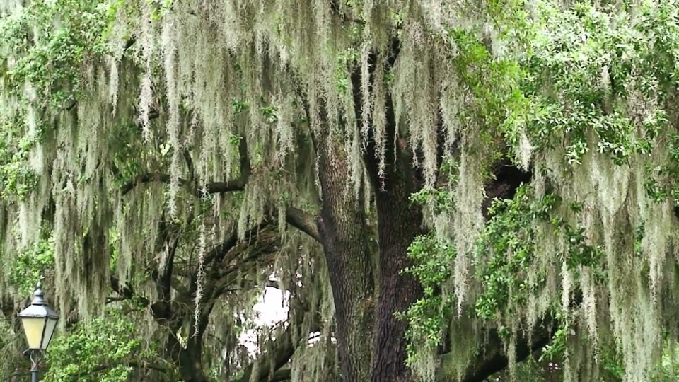

Sorry to double post, I wasn't going to be able to sleep without being a little more scientific about the issue I brought up. Below are comparable frame grabs of renders of .wmv (left side) and .mp4 (right side) of same footage @ 8Mbps in both formats from Vegas Pro 8. After looking at them, I'd have to say the .mp4 is slightly better, all things considered.
1. Note slightly more pixelation in water run-off in .wmv than .mp4 on fountain.
2. Note slight better sharpness of moss and tree bark of .mp4 on mossy trees.
3. Note car tags on .mp4 are sharper than tags in .wmv
4. Riverboat seems approximately a tie. I can stretch and think the writing on riverboat bow and writing on rear of tractor trailer is a little sharper, but its very slight, if at all.
The .mp4 file is approximately 5% bigger file on average than .wmv in these 4 pictures, but seemed to render a little faster. In moving frames, these differences are very slight, so I won't be rushing to re-render my files to .mp4 that have already been rendered to .wmv.
Roger Shealy is offline   Reply With Quote

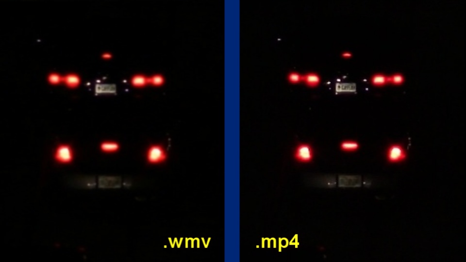

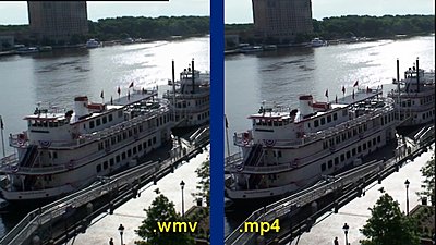

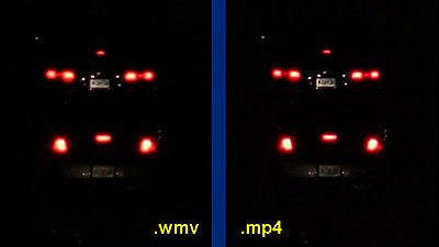

Perhaps a better way to compare (all zoomed to some degree):
.wmv and H.264-fountain-comparison.jpg   .wmv and H.264-mossy-tree-comparison.jpg
.wmv and H.264-night-car-tag-comparison.jpg   .wmv and H.264-riverboat-comparison.jpg
Old May 29th, 2009, 11:13 PM   #14
Location: Bangkok, Thailand
Posts: 143
Thanks Roger for taking time to do the tests and showed us the results. To my eyes, all H.264 grabs look sharper and have more details. To be fair, though, could you give us more details on the level or complexity of encoding, e.g. number of passes, the use of bi-directional predictive frames, level of "profile" as in "baseline", "main" or "high" in the case of H.264 encoding scheme etc.
I'm on a Mac system and not familiar with WMV encoding so you or someone here could suggest a level that's comparable to that of H.264. The use of equal data rate and total processing time (by the same NLE and on the same computer) is certainly a good start.
