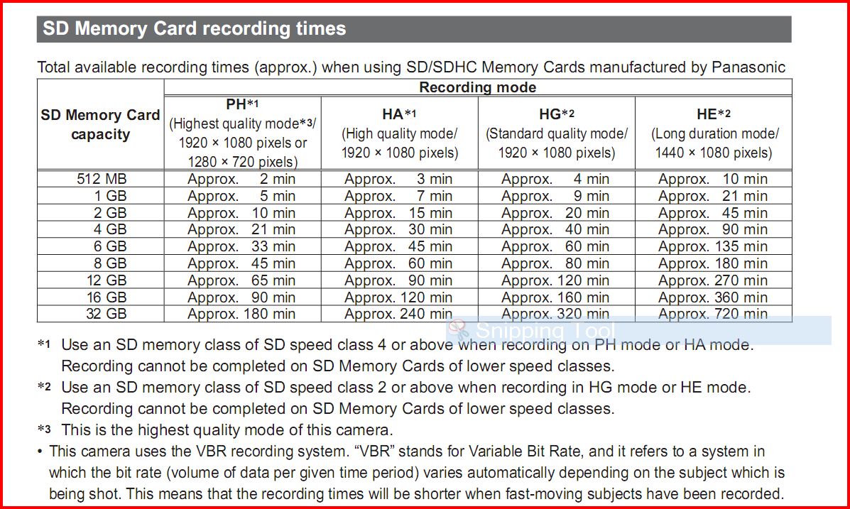

The User Manual for the HMC150 (on page 32) states, just as Ben originally posted, that a Class 4 card was recommended for the highest rate ("PH" mode) recordings, and I have included a clip of that page for reference below. Hence my earlier suggestion.
It did strike me as a bit low, all considered, but Panasonic must be confident that this Class 4 speed achieves the required performance. It is indeed true that some if not most of 24Mbit/sec camcorders prefer / demand Class 6 cards, and the small cost penalty may be worth it as extra "insurance" against some type of recording errors / issues.
