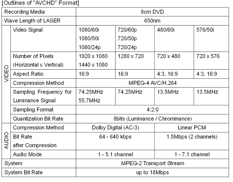

And here's the format table (click image to see full size):

Can anyone explain what it means that the compression format is H.264, but the "system" is MPEG2-TS? What kind of headache will that be to edit?!
Kevin Shaw is offline   Reply With Quote
Transport Tream is HOW the AVC is sent via cable or broadcast or recorded to any media.
It is MPEG-2 Transport Stream because that what's used for cable and broadcast. And, that's critical because it allows MPEG-2 to be replaced by H.264. DirectTV is already going this route. So is USBTV.
Won't be any different than HDV.
This is NOT the same Profile@Level of H.264 that will be used on P2. This is High 10 profile (Hi10P) Level 4.0 which has a maximum of 20Mbps.
High 4:2:2 profile (H422P) Level 4.1 has a maximum of 50Mbps.
