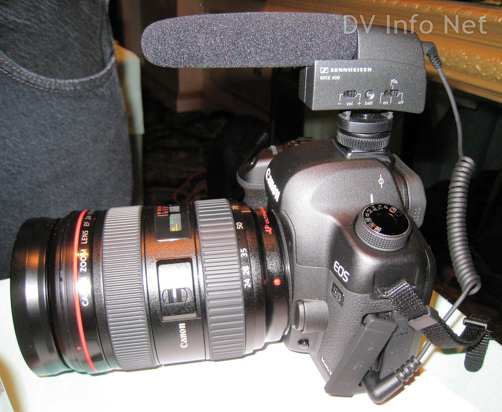

Found out yesterday how the Canon 5D Mk. II handles exposure during its video recording mode: exposure is auto when recording HD video, and is adjusted by the camera in a particular order which is based on creating as little audible camera noise as possible so as not to affect the sound that's also being recorded.
The AE adjustment order is ISO (gain), followed by shutter speed, followed by aperture.
The idea behind this is that changing the ISO is an electronic function which does not generate audible camera noise, so it is prioritized as the first parameter to be adjusted by the AE function. Shutter speed is next, but HD video recording in the 5D Mk. II is limited to a narrow shutter speed range of just 1/30th sec. to 1/125th sec. Finally, the aperture is changed only as a last resort due to the physical noise generated by the camera's mechanical iris blades (heard as a series of clicking sounds).
Exposure can be locked, of course, which freezes all of the AE adjustment parameters (ISO, shutter, aperture) into their current positions. You'd have to use the manual exposure "trick" described in our Canon HV Series forum, using a bounce card or some other source to force your desired exposure, and then lock that exposure which will prevent the AE from working, and then compose your shot before starting the recording.

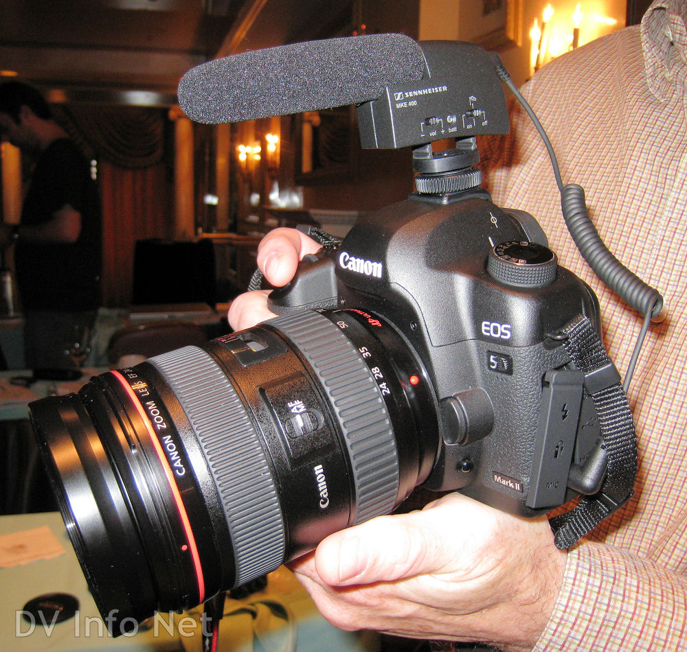

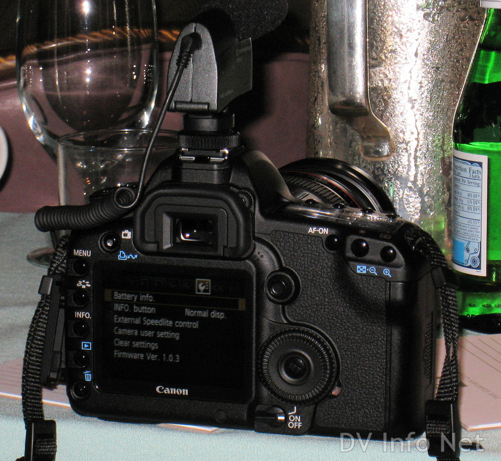

In the photos below (click to see 'em big), a Sennheiser MKE400 stereo mini-shotgun mic is attached to the 5D Mk. II's hot shoe and is plugged in via the 1/8th-inch stereo mini jack on the left side of the camera (thanks Mike). This or most any other external mic will be highly preferable to using the camera's built-in mic; however there is no provision for manual audio level adjustment, and worse, no way to externally monitor live audio recording through headphones. The camera has a standard AV output jack, which on Canon digital video camcorders (such as the current VIXIA line) can be reconfigured via menu to function as a headphone output -- unfortunately that critical feature has not been included in the Canon 5D Mk. II's menu system.

Some 5D Mk. II notes on AE, and images of the camera and box-5dsenn400mic1.jpg   Some 5D Mk. II notes on AE, and images of the camera and box-5dsenn400mic2.jpg
Some 5D Mk. II notes on AE, and images of the camera and box-5dbackmic.jpg   Some 5D Mk. II notes on AE, and images of the camera and box-5dbox1.jpg
