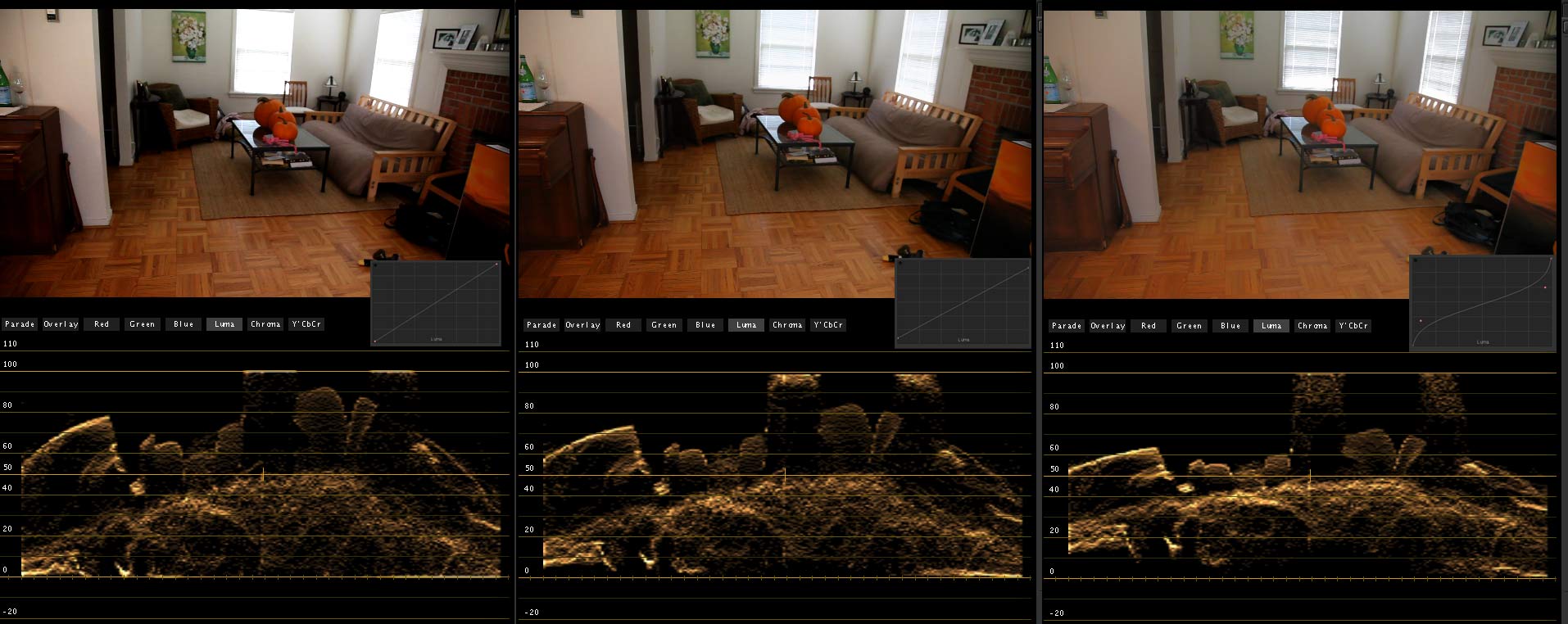

* We make custom profiles for the 5D MkII that compress the range to 16-235 using the supplied Picture Style Editor. Load the profile into the camera, and the video will be in-range. No need for a firmware update.
I actually am back to thinking this may be a good idea, but not just because of the range issue - I'm noticing that even when working with stuff in color there is a lot of crushing of values around black and white, as if the camera is applying a strong S gamma curve.
Shifting just the input/output in the luma curve brings back the detail lost due to the qt rgb clipping issue, but still leaves the blacks and whites crushed. Take a look at the example below - the first is the straight clip, the second is with Jon's luma adjustment, the third with an inverted S-curve. That may be too flat depending on your taste but to my eye that's what we need in a color profile in order to get away from baking in the high contrast look in camera.

Nice example, Evan,
I think the flatter result (3rd example) would lend itself to the most flexibility in post - especially when working in 32-bit mode. However, if you know you want crushed blacks, go with the second example.
I prefer the second one. It handles white better without decreasing contrast too much. The third one does pull out some dark detail, but at the expense of contrast in the lower mid tones.
With Color it should be possible to bring out some shadow detail with affecting overall contrast. I'm curious how good shadow detail looks noise-wise.
What was the ISO on these clips?

Evan,
On your inverse S-curve, the end points are still in clipping territory (0 and 255). Ideally, they would end at 16 and 235, but you would still have some inverse S-curve applied. The curves could be more subtle in that case.

Evan,
Not sure what you mean - that S curve brings all values in the original image into the 0-100% range on the scopes just like your example does - nothing is clipped. If you did want a more subtle curve you might need to pull the end points in, but my goal was to make use of the maximum available data.
Not sure on the ISO, that was just a random clip I grabbed. There's certainly a lot of room to adjust the overall image in Color but you do have to watch out for shadow noise, which seems to be compounded by macroblocking from the compression. With the curve I wasn't actually looking to produce the most pleasing final image as much as figure out how to maximize the image data before compression and hopefully minimize the shadow noise - better to crush it back down in post than have to stretch it too much.
As Jon mentioned the curve would be best when you know you're going to do extensive grading in post and for more casual stuff you'll probably something with a little more contrast. I'm going to try a few different curves in the picture style editor and see how they affect the shadow noise and clipping.
Edit: just spent a few minutes messing with the picture style editor... this is going to be more difficult than I thought. The gamma curve control is pretty bad, it doesn't lend itself to much more than fairly subtle adjustments because it has very strong fixed bias through the control points. It looks as if you actually can't really move the end points either - manually entering 16-235 for the endpoints results in a steep 90 degree bend in the curve.
