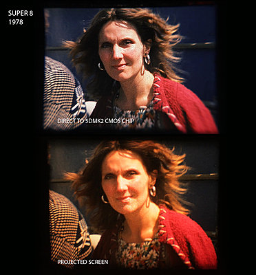

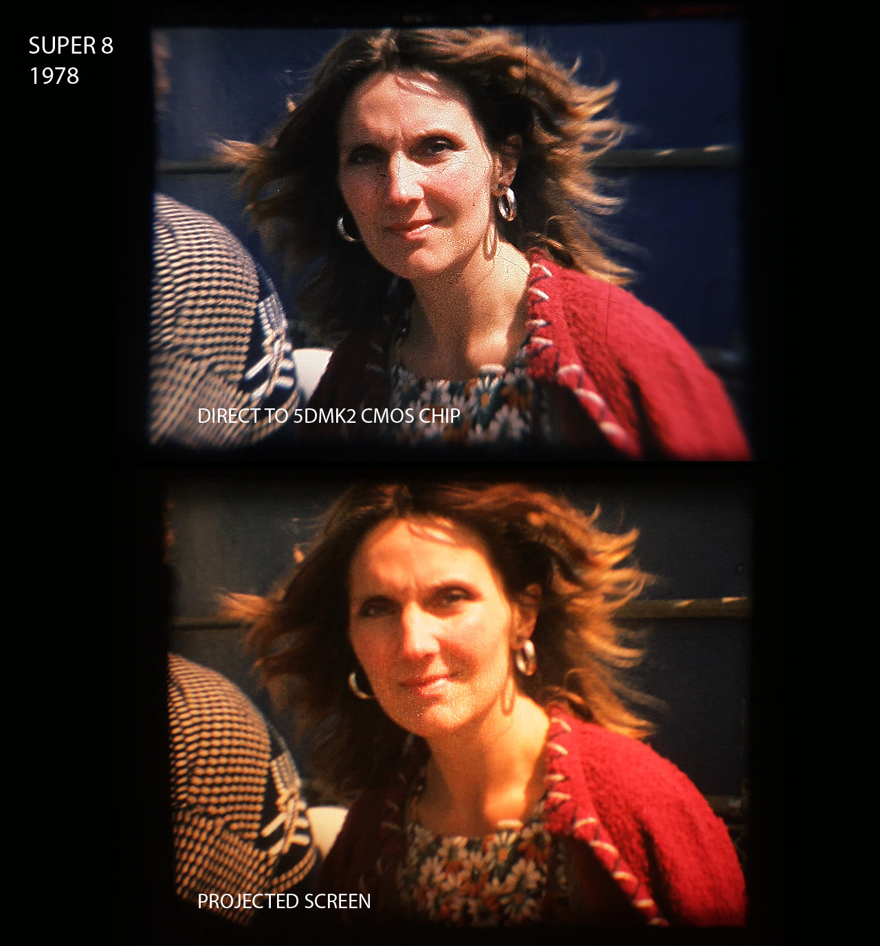

Here is a quick grab of projected verses direct cmos capture.
10w bulb used instead of the 100w. Trying with dimmable luxeon Star led tomorrow.
Just trying to minimize the edge softness. The projected WB is out but you get the idea.
The 6mm aperture used was made using a copper 2 pence, sprayed matt black (sorry Queen)
Also, I have focused on the front of the film, should have been the emulsion, hence more scratches.

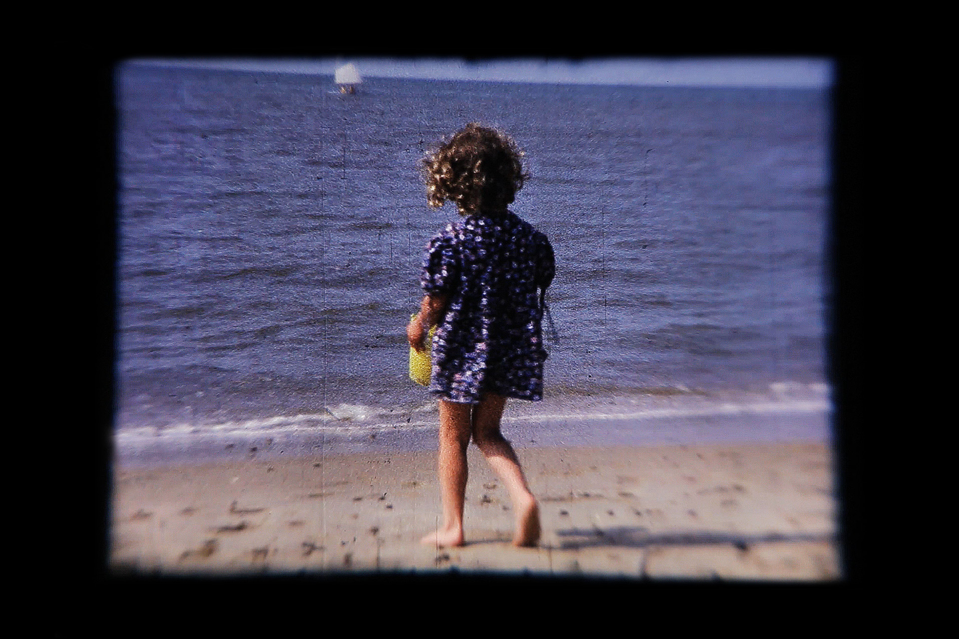

Here is another frame from a different reel. (Full resolution frame exported from quicktime)

What's interesting is that your projected image is sharper into the corners than the direct to 5D frame Also the dof of the latter means you're capturing the scratches on the substrate, and you really need a very shallow dof so that only the emulsion is sharply focused. Maybe make the hole in the washer larger. And use something very thin for this aperture so that you get as little flare as possible from the edges.
Unless the projector's gate is allowing the film to curl (which I doubt) it looks as if the fast projection lens doesn't have a very flat field. The design intent was (in 1973) to put as much light onto the centre of the screen as possible, and pretty much all else was side-stepped to get this result.
I use a Schneider Xenovaron f/1.1 zoom in my Elmo GS1200. It has a wonderfully flat field and is noticeably better than Elmo's f/1.0.
Can uoi use a macro lens on the 5D to photograph the frame directly in the projector's gate and bypass the projection lens? There are some fascinating pages here on building your own machine out of an old Eumig projector:

James - though it's beautifully sharp in the middle circle, outside of that the image quality falls off dramatically, so sommat's up. If you look through the 5D's v/finder you should see the same situation, so I suspect the projection lens rather than bowed film in the gate.
