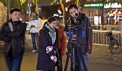

And a quick pic of me in action with my 5DmkII rig tonight.
Dan
