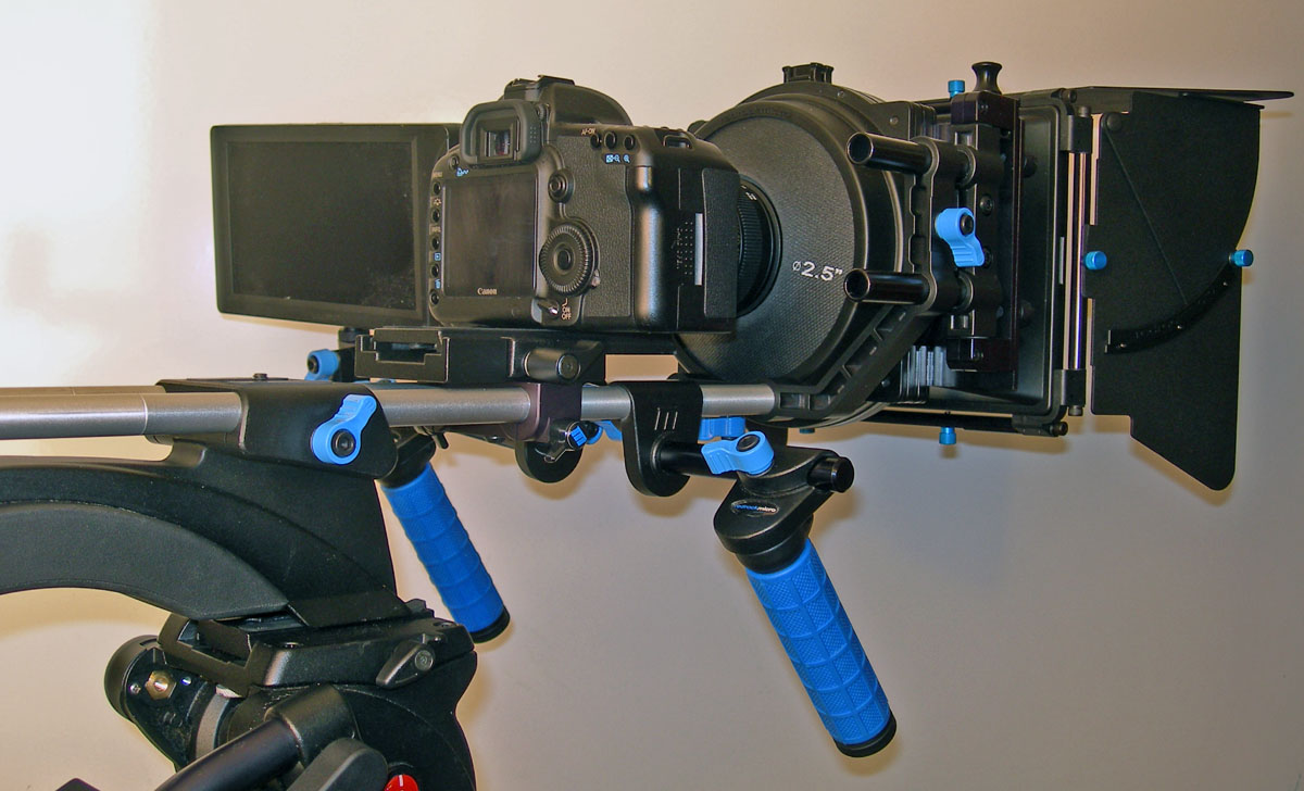

I just leave mine on the RedRock Micro Shoulder Mount. Works fine for what I need and makes the camera much more practical for hand held work. I just wish it had a handle on top, carrying this thing on anything other than a shoulder is clumsy. I don't want the cage because of the extra weight and it's a bit expensive.

Hi Daniel, nice looking rig there. May I know if the config u have there is the
- Redrock micro shoulder mount
- microShoulderMount Rod Clamp Add-On?? (looks like a quick release but i cant figure which part is that)
- microMatteBox Deluxe Bundle including Flag Kit

It's a little different right now and I'm still making adjustments to find the best configuration.
You have most of the components right. The extra rod clamp was a bit big so I secured the Bogen Quick Release plate on to a MicroClamp instead. It's shorter and allows for the camera to move closer over the shoulder for better weight distribution. The release plate overlaps with the shoulder support rod clamp.
I had to drill the center microClamp hole just a bit wider and used a 1/4" thumb screw to secure the Bogen quick release adapter. I don't remember which quick release adapter it is, I think its the 577.

I agree with Noah, the grips design on the cavision kit is much better although a little less flexible. It's true that on the redrock setup if its not locked tight enough it will slip. So far it has remained secure with a 4lb battery, mattebox, LCD, the 5D2, zoom lens and follow focus. Overall it's solid, the grips are rubber, and shoulder pad is soft and for me that was important.
