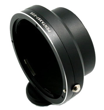

Liam, The adapter that I use is the PENTAX67-EOS. It allows you to convert Pentax 67 lenses to fit on most Canon EOS/EF Digital or film camera bodies.
They can be bought online or from many sellers on Ebay. Make sure that you buy the metal adapter, and that it also has a seperate pin at the side for the front bayonet catch, so that you can leave the adapter in place on the 5D body and quickly change lenses when needed without having to remove the adpater each time.
To use, simply attach the ring to your lens and then the lens to the camera. When you have finished, remove both together (There are front & rear bayonets on the Pentax67-EOS Adapter).
This adapter has a tripod mount. (This is a huge plus factor for me because it balances the 5D Mark II very nicely on a tripod, allows me to fit a Manfrotto Quick Release Plate directly to the lens; provides extra support for handholding, and prevents any extra strain on the Canon 5D bayonet mount).
It is made of high quality copper and aluminum - so is solid. It also comes with a pouch.
It allows full range of focus to infinity. Manual control of camera functions and camera will meter correctly in stop-down mode.

There are two type of Pentax67-EOS adapters - one is the basic model that I use, or the more expensive model (double the price) that has electronic contacts so that the Canon 5D Mark II camera shows "In-Focus" confirmation light inside viewfinder when a Pentax 67 lens is attached. I rarely ever use the In-Focus confirmation light, even when I'm using EOS EF lenses, so saved money on the fully manual model.
There are very similar adapters available for the Pentax 645 MF and Mamiya 645 MF and Contax 645 MF.

Here are photos of the Pentax67-EOS adapter with release pin for front bayonet lens mount showing on right side (the rear bayonet fits to the camera body). Second photo shows tripod foot, and the lower image shows the Pentax67-EOS 'Focus Confirmation' adapter with electronic strip on rim:
LENSES FOR STILLS & VIDEO an alternative view-pentax-67-canon-eos-ef.jpg   LENSES FOR STILLS & VIDEO an alternative view-pentax67-eos-adapter.jpg

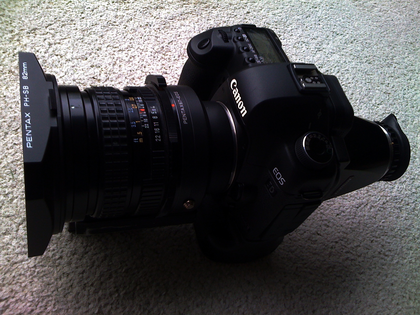

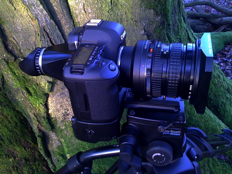

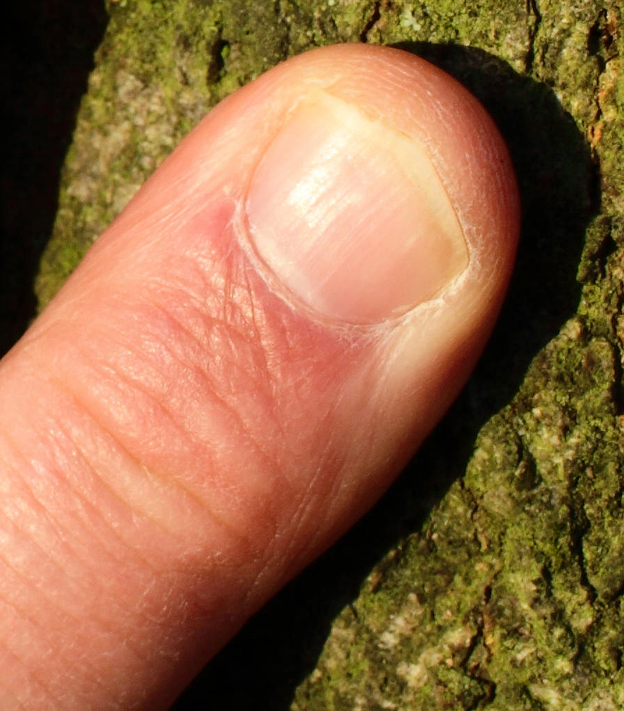

After weeks of cold winter rain in UK, the sun finally shone for a few hours today, so I went out into the local woods to obtain some video footage. While I was there, I also used a few extra minutes to take some stills, mainly just for lens checks. I am uploading these via my phone dongle (cellphone) connection, so quite a lot of quality is lost in compression over the air waves, but hopefully you'll be able to see the quality of this MF Pentax 67 optic.
The first image is of a moss-covered tree (click on images to open, and then press '+' sign to enlarge image). Image 2 is a close up of the moss-covered roots. Image 3 is the Pentax SMC 67 45mm f/4 lens on the Canon 5D Mark II (photo taken on my iPhone).
Image 4 is my left hand on the bark of the tree. The last image is a 100% Crop of the same image of my hand (after opening image 5, click on '+' sign again to enlarge full size image - you need to click on the same image three times to open up full size. This is a magnified CROP of the previous image). It shows this is a sharp optic. I really like using this lens!
LENSES FOR STILLS & VIDEO an alternative view-pentax-67-45mm-tree-edge.jpg   LENSES FOR STILLS & VIDEO an alternative view-roots-time-pentax-67-45mm-canon-5d-mkii.jpeg
LENSES FOR STILLS & VIDEO an alternative view-pentax-67-45mm-canon-5d-mk2-vinten-tripod.jpg   LENSES FOR STILLS & VIDEO an alternative view-pentax-67-45mm-canon-5d-mk2-hand.jpg
LENSES FOR STILLS & VIDEO an alternative view-pentax-67-45mm-hand-finger-crop.jpg

Love the shot of your rig, Tony.
The viewfinder hood looks like one of those Hasselblad chimney finders you spoke of earlier. How do you have that mounted ?
I'm definitely thinking Pentax lenses now.
