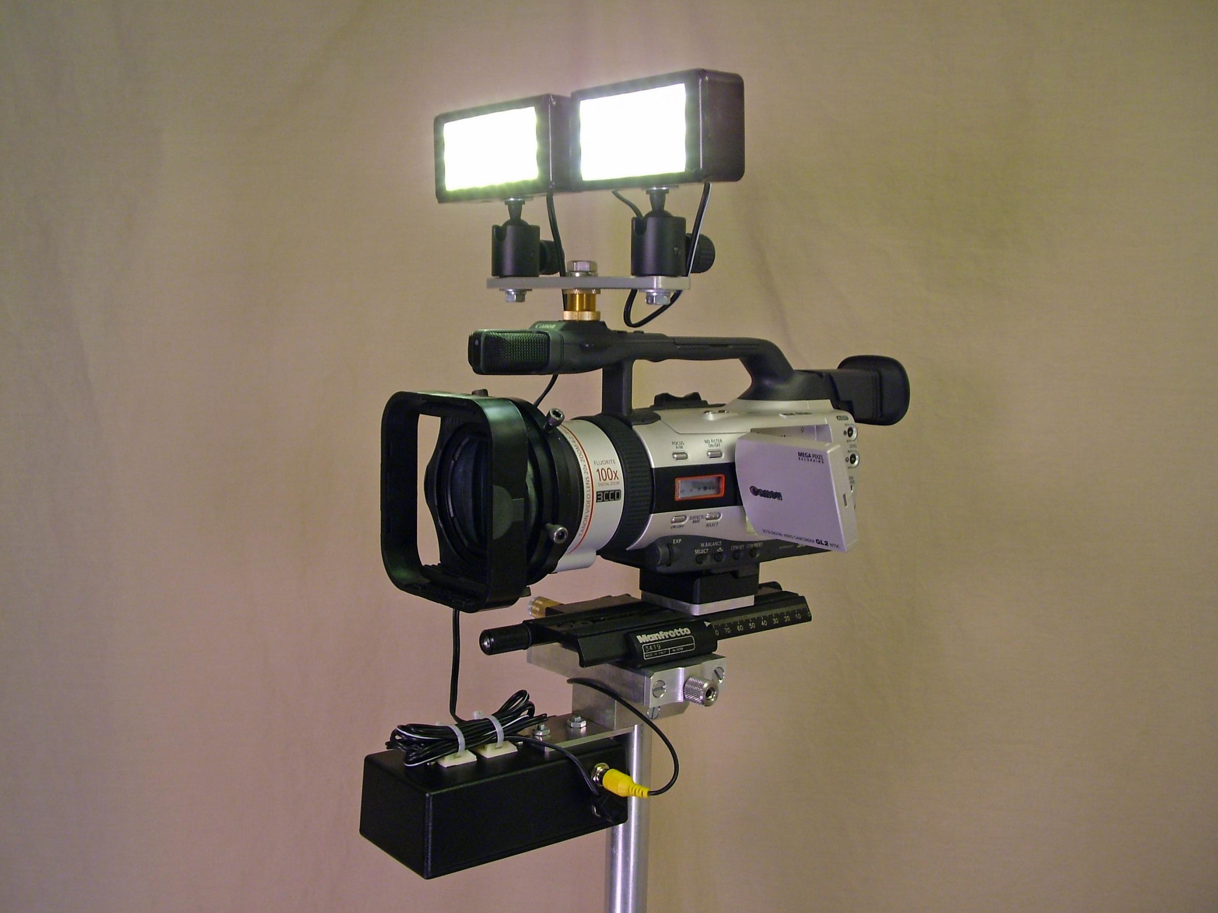

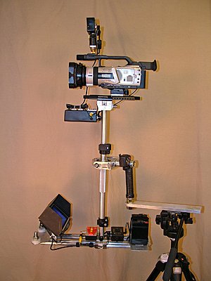

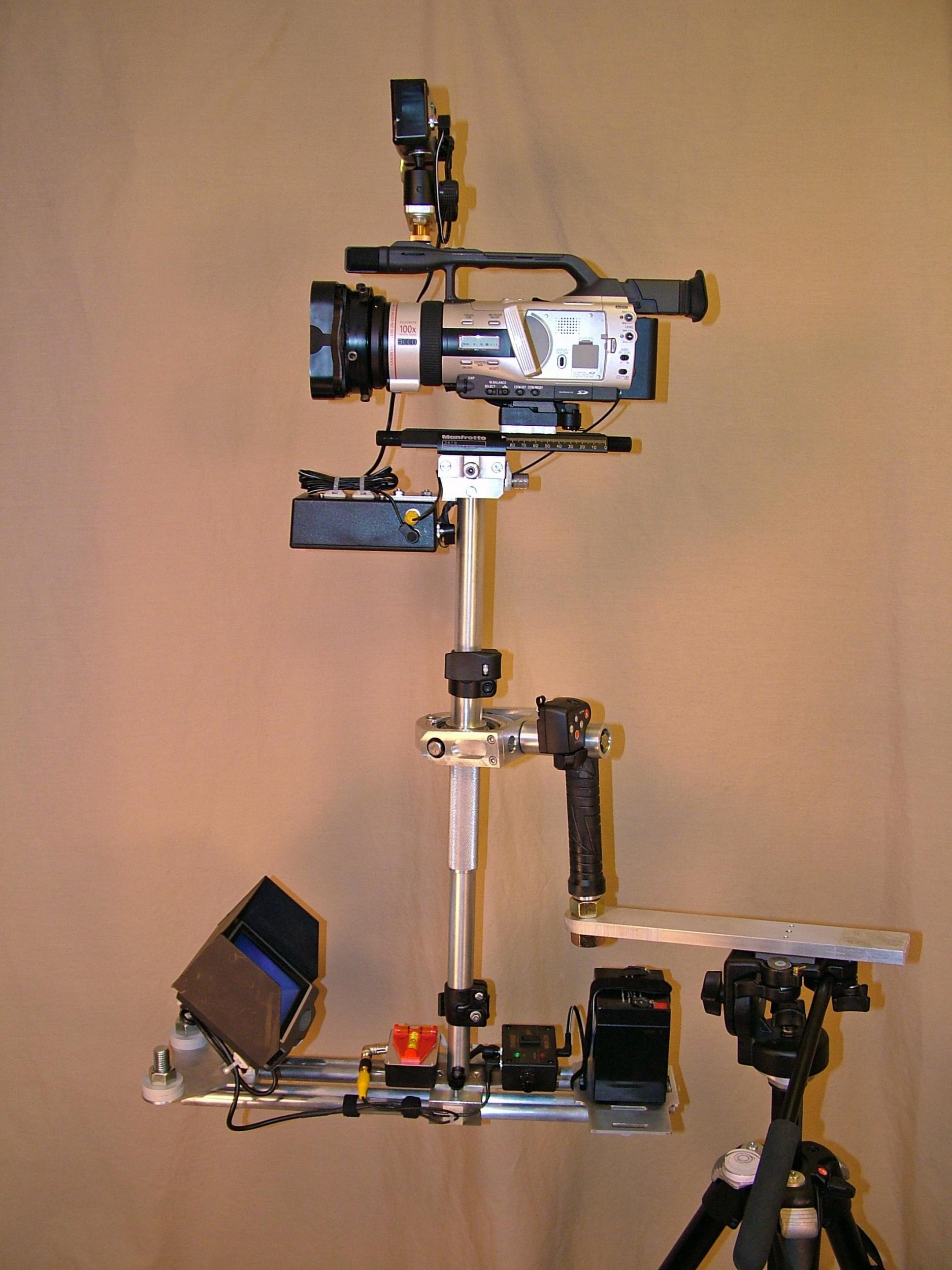

Hello gang,
Here are a few pics of my GL2 flying on my home-built Steadicam sled. I'm in the process of completing the vest and suspension arm to hold the sled, but everything wont be finished for quite a while (the sled took 11 months to complete... )
Just thought this might make some good conversation on the board :)
Dave
Here is a more detailed posting on how I built my rig: http://www.dvinfo.net/conf/stabilize...challenge.html
GL2 on a home-built camera stabilizer-dscf5180.jpg   GL2 on a home-built camera stabilizer-dscf5189.jpg

Nice one David! What is the overall weight? Have you submitted it to "Homestabelizers"?
What are the lights? Make/link?
Grazie

What kind of lights are you running?

Thanks guys,
Grazie, yep totally on the HBS (Home Built Stabilizer) board. That's where I got most of my ideas and help. So to that end Jeff, if your interested in trying this yourself, you may want to check out that site. Most of the parts I designed were on the fly, so there are no blueprints or drawings other then my original prototype ideas. It's not that I don't want to take the system apart and one by one measure each part, draw, and publish a How-to manual, but the machining process is very difficult for the average home-builder to accomplish. Without the support of my cousin and his thousands of dollars in metal working equipment I would never have been able to accomplish this much. So unless you have a machine shop in your basement, I don't advise doing this...
The LED lights are homemade. I have three different sets with different Kelvin color temps. The lights pictured are my only dual set, so they would be the heaviest of all to fly. The lights are dimmable, and have 135 degrees of spread, so there is even light output without any hot-spots.
As for the weight of the system, it's 10 lbs naked, and 20 lbs with all the equipment you see in the pictures. Not something you can hold for very long hand held, that's why I'm going to have to finish the arm and vest to be able to use it to it's full advantage.
