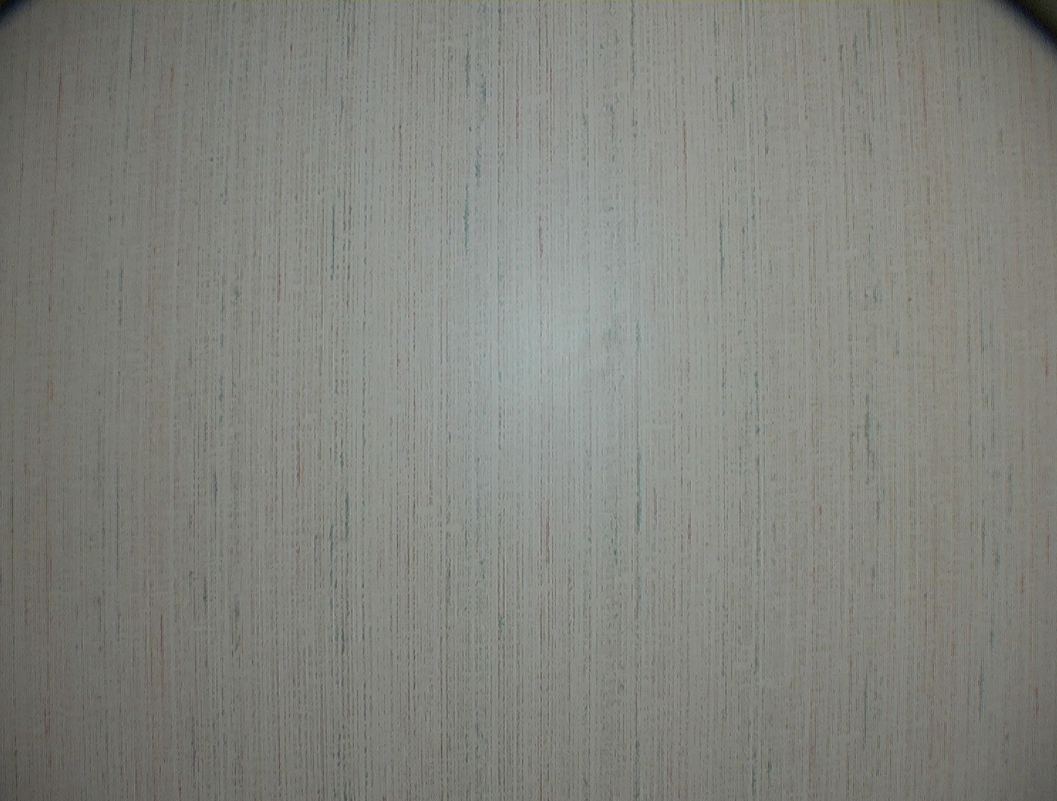

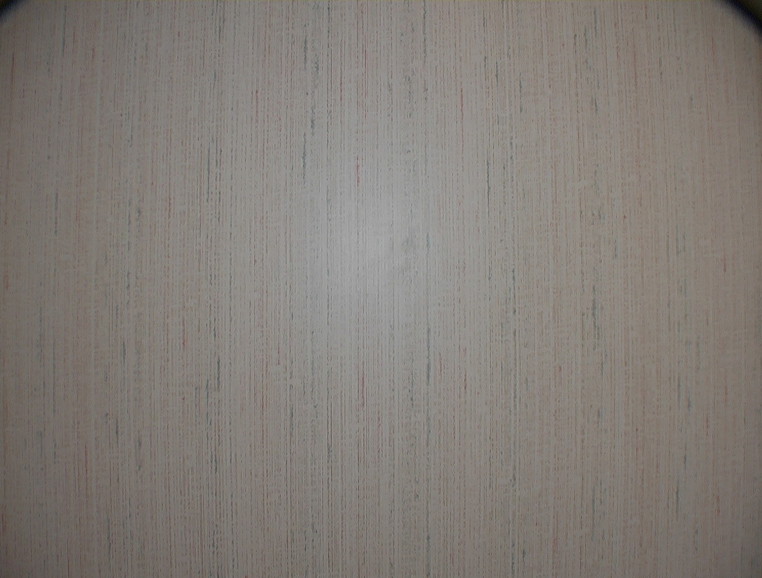

Hello Ryan,
I have something similar and I didn't notice it until after I captured my video into Premiere Pro CS3. At first I thought it was my lens hood, but I removed the hood and took some digital shots with the camera. In the upper corners there are some Vignette shadows. I also tried turning the adaptor 90 & 180 degrees, and I tried remounting the adaptor again at 90 & 180 degrees. With all the different mounting techniques I still have the little shadows in the same corners. I know that there is a small amount of lost picture after I render a DVD video (that's what the "Safe" margins are for) unfortunately, when I render a Media file for posting online the entire image is used, so Safe margins are not relevant and the shadows do appear. I'm just curious if this is normal. Here are some pictures that I took with the camera.
Adaptor1 is a picture with the adaptor mounted normaly.
Adaptor2 is a picture with the adaptor mounted 90 degrees CW.
Also, there is a small dust particle inside the adaptor that I cannot clean. So far I've not noticed it on the final videos, but can I send it in for cleaning?
Century Optics 16:9 Widescreen Adapter-adaptor1.jpg   Century Optics 16:9 Widescreen Adapter-adaptor2.jpg

Originally Posted by David L. Holmes View Post
Hello Ryan,
In editing at underscan in certain software packages you will likely see some vignetting but it shouldn't be as bad as in the previous post. It was designed not to come out on the final image but not all editing programs are the same and it is difficult for us to predict or test how each will work.
Is this coming out on your final image when displayed on a TV or other media?
You can send the lens in for a cleaning. Mail it to our California Office to the attention of John Sioringas our service manager.

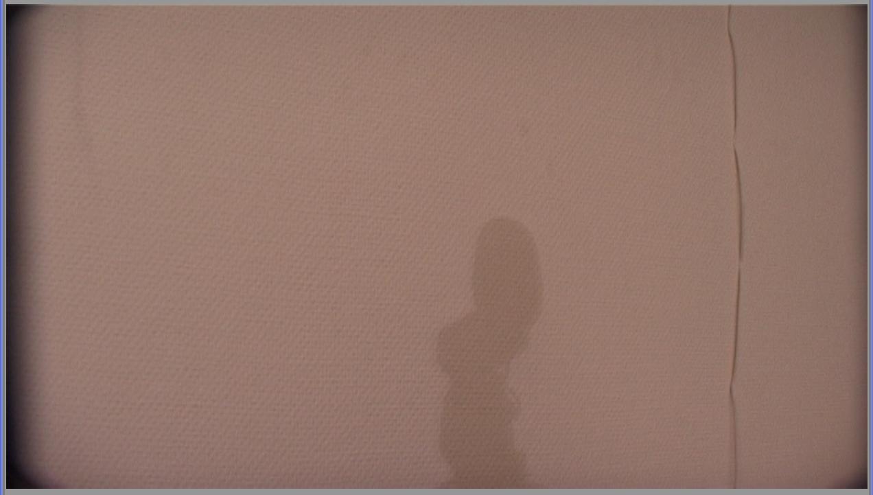

Ryan, thanks again. I use Premiere CS2 and have now imported the footage. (yes, i previously captured it straight off the camera without any editing) I have unsqueezed the image (using the method Tom Blizzard described in http://www.dvinfo.net/conf/showthrea...=112482&page=2 ) and i am still left with vignetting.
Picture:
http://users.bart.nl/users/mvdzaan/v...picture006.jpg
What should i do now? Thanks.
Is there something wrong with the lens, because this doesn't look normal to me? (?) Or is it? Basicly it seems to me that this lens just doesn't fit the VX2100 properly. Thus as you said, it might be a design flaw? (?)
I play my footage via beamer/projector/lcd screen only, so what i see in my editing window is what i, and the people i make documentaries for, will see on screen. The safe area comes in handy, but for these output sources is pretty much something of the past i believe.
Thanks again for your help.
Picture:
Send it back to us for testing and evaluation. We have obviously exhausted what I can do for you over the internet. It is my bet that you got an older model that slipped past the modifications we made. A rare occurance but like I said it was an inventory clearance sale so anything was possible. We will do our best to ensure that your Century attachment performs to the highest standard we can make it.

Hey Tom. Thanks for the heads up. I have received an email from Schneider stating that both lenses have passed the quality test. So i guess i am unlucky.
However i wonder why mr David L. Holmes has much less vignetting than i have. (see the attachment) Is this a difference between camera types? (he is using a GL2, i am using a Sony VX2100)
I have shown my footage to a few clients. Out of three, two complained about the vignetting, 'What is that?' So it is something i have to care about. My only solution is to cut about 10% from the picture, (basicly both so called 'overscan' sides) so the whole vignetting is not visible. I can then either zoom the picture (in post) or leave it with two small black bars at the left/right. Which in both cases looks much less distracting than the vignetting. -> And people do not start to wonder if something is wrong.
I don't want to bash Schneider, because they have been very helpful. They also don't charge me for any return shipping costs. (i am very glad, because the shipping to Schneider cost me 75 euro) But i still think my vignetting problem is quite bad. How much vignetting do you have Tom? Could you make a screenshot? (in windows xp, just click on the cam in my computer and find the button 'make snapshot')
