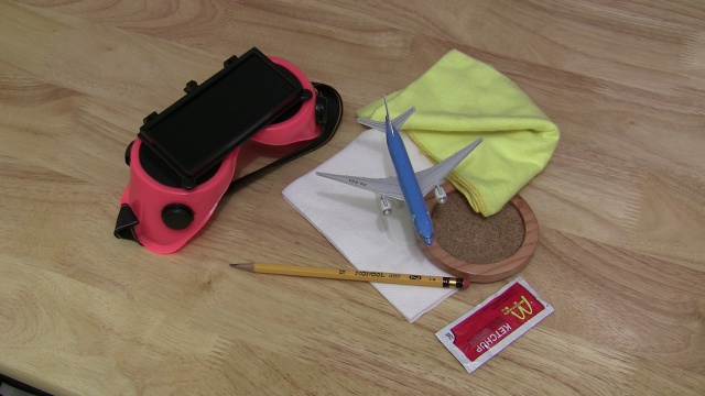

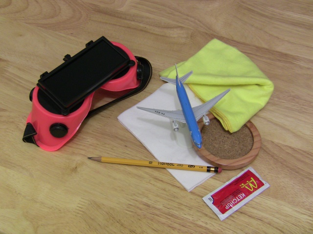

My results, using same custom white balance setting on both.
HF10/HF100 color issue?-still-mode.jpg   HF10/HF100 color issue?-capture-mode.jpg
wow, looks very close, Mugurel!
can you say what software you used to capture this, rendered and decoder?
I wish I could do this as close as you did!
Boris Key is offline   Reply With Quote
Old December 4th, 2008, 10:52 PM   #7
Location: Philippines
Posts: 253
For the video part I use VirtualDubMOD and the decoder is CoreAVC (Money well spent). I am on PC here.
Lost signature, if you find it, please return it to me, thank you.
Mugurel Dragusin is offline   Reply With Quote
Old December 4th, 2008, 11:04 PM   #8
Location: Fort Myers, FL
Posts: 11
thanks again! it means it is not the camcorder that do the mess but decoder. I am relieved now :)
