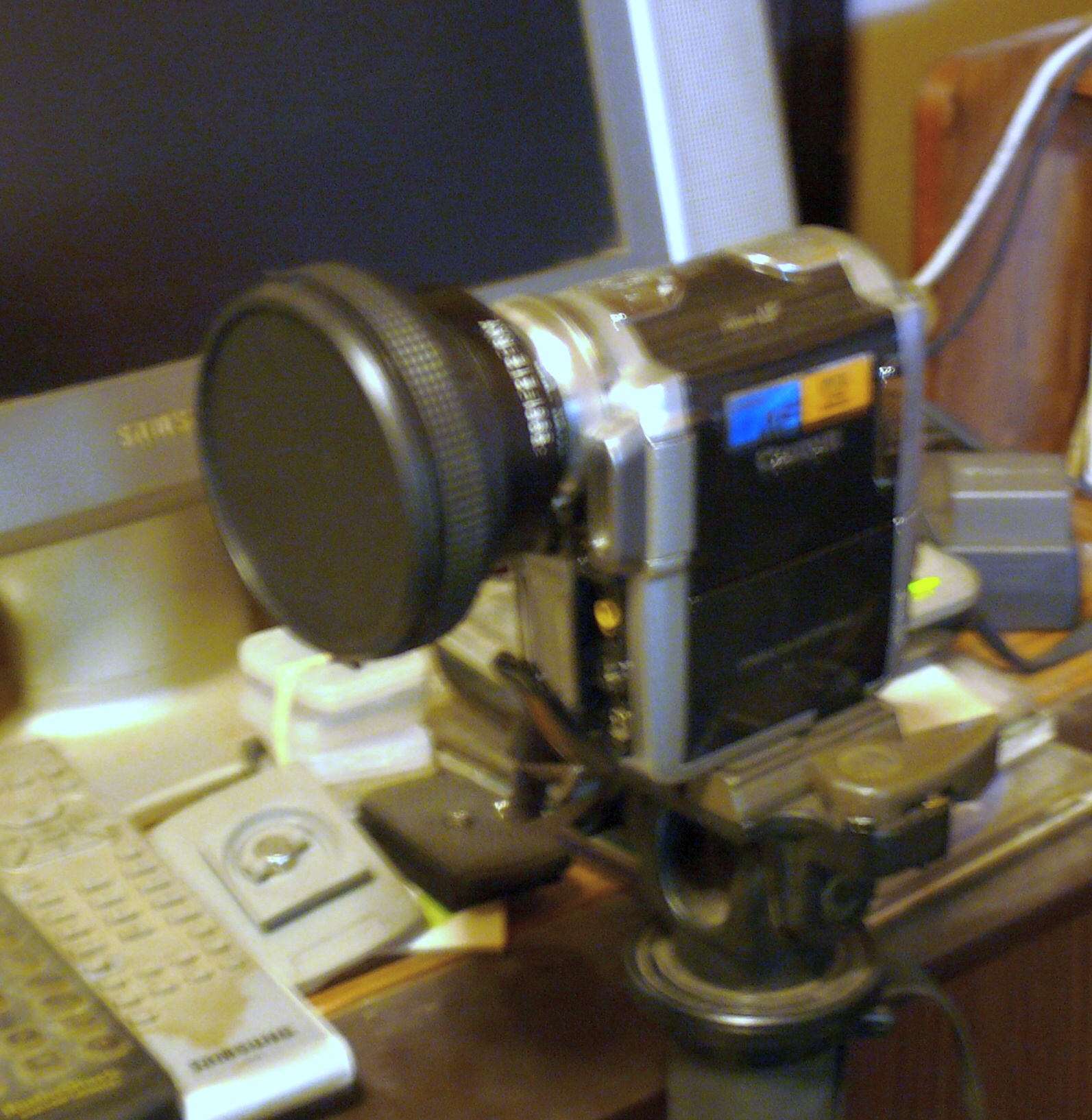

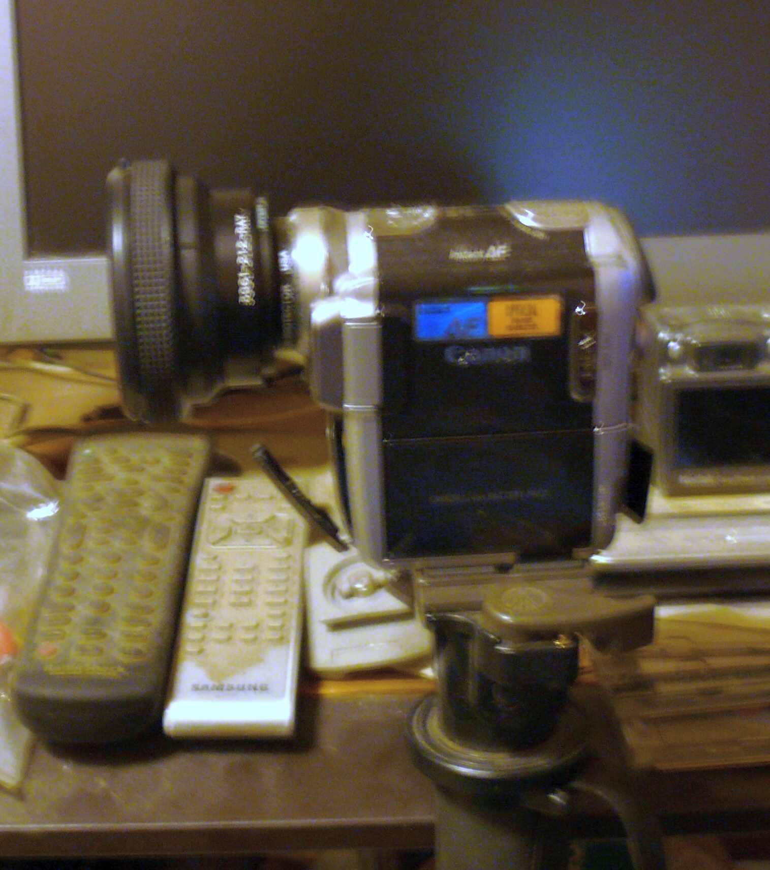

Raynox 6600Pro WA on Canon HV10
Marton,
Yes, I own a Canon HV10 and a Raynox 6600Pro WA lens. I use a 37-49mm upsizing ring to make the connection. So, my WA lens is 49mm. The reason I bought the 49mm WA was to enable use with my Panasonic GS250, as well as with the Canon HV10, the former being 49mm and does not require the step-up ring adapter.
Sorry, I cannot answer your question about the 55mm Raynox, and or 55mm filters/polarizer, as I do not own these items.
I have not noticed any vignetting, barrel distortion, or chromatic aberration with the 49mm WA lens on my HV10. It's been awhile since I used this WA lens on my Panasonic GS250 but, I vaguely recall there may have been a very slight amount of vignetting when used on this camcorder. Then again, I'm relying upon distant recollection, so the vignetting I'm thinking about could well have involved other lenses I've used with the Panasonic.
I remain 100% happy with the Raynox 6600Pro WA lens! I can't imagine a WA lens that produces a better match with the Canon HV10, and better image quality. The size and weight of this WA lens in relation to it's connection to the small HV10 is not a problem where I am concerned.
I attach two photos (sorry for low-light image quality) which depict the 6600Pro WA mounted on my Canon HV10 and monopod.
See attached ...
VM
Wide angle adapter HV20-raynox-6600-pro-canon-hv10.jpg   Wide angle adapter HV20-raynox-6600-pro-canon-hv10-alt.jpg
