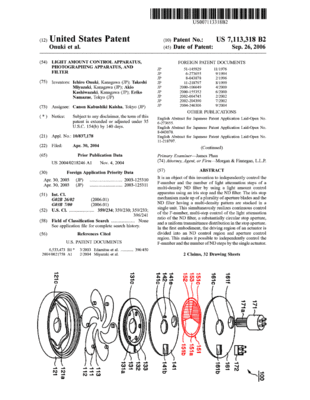

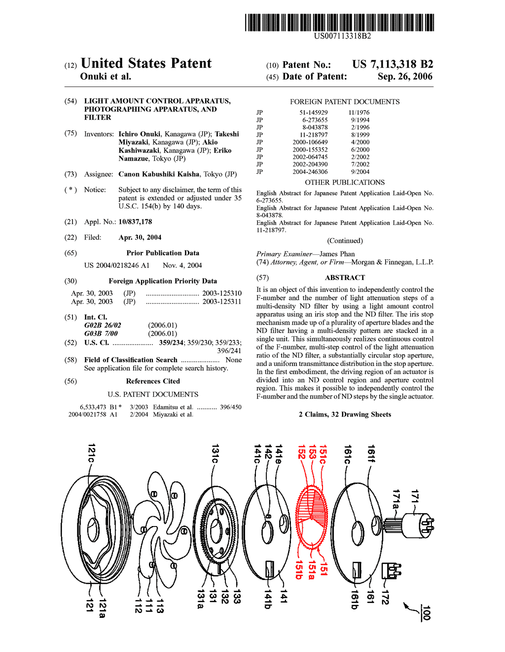

Some of Canon's publicity for the HV10 camcorder refers to its "patented Gradation ND system." I searched the US Patent Office for the term "Gradation ND" and found Canon's US patent no. 7,113,318 ... filed April 30, 2004 and granted on Sep. 26, 2006 (around the time the HV10 went on sale).
http://patft.uspto.gov/netacgi/nph-P...&RS=PN/7113318 Haven't read all the text yet. But in the images link, Figures 9B and 9C illustrate a control scheme. Starting at 1/30th shutter speed, the camcorder reacts to brightening light by stopping down the iris from f2 to f8. Then steps of neutral density filtration are added, as the iris first dilates and then stops down again. Finally, with increasing brightness, the shutter speed is then quickened in steps from 1/30th up to 1/250th, 1/500th, etc. I hope that someone more technically proficient than I can read this patent, and spell out for HV10 end users how to maximize mechanical control of the camcorder. For instance, I would assume that in bright light, it might still make sense to use an external ND filter, if one wanted to manually force a slow shutter speed and/or dilated iris while avoiding overexposure. Last edited by Mike Brown; December 13th, 2006 at 07:09 PM. |

I think the red thing (my emphasis) is the ND filter 2 X ND + clear (??).

Another still shot control scheme without ND filters is also described, so it is not 100% clear that the one quoted above is being used. Also, nothing in the patent specifically references the HV10 camcorder. However, Canon's HV10 publicity referring to the "patented Gradation ND" system strongly suggests that one of the schemes mentioned in the patent is being used. |
