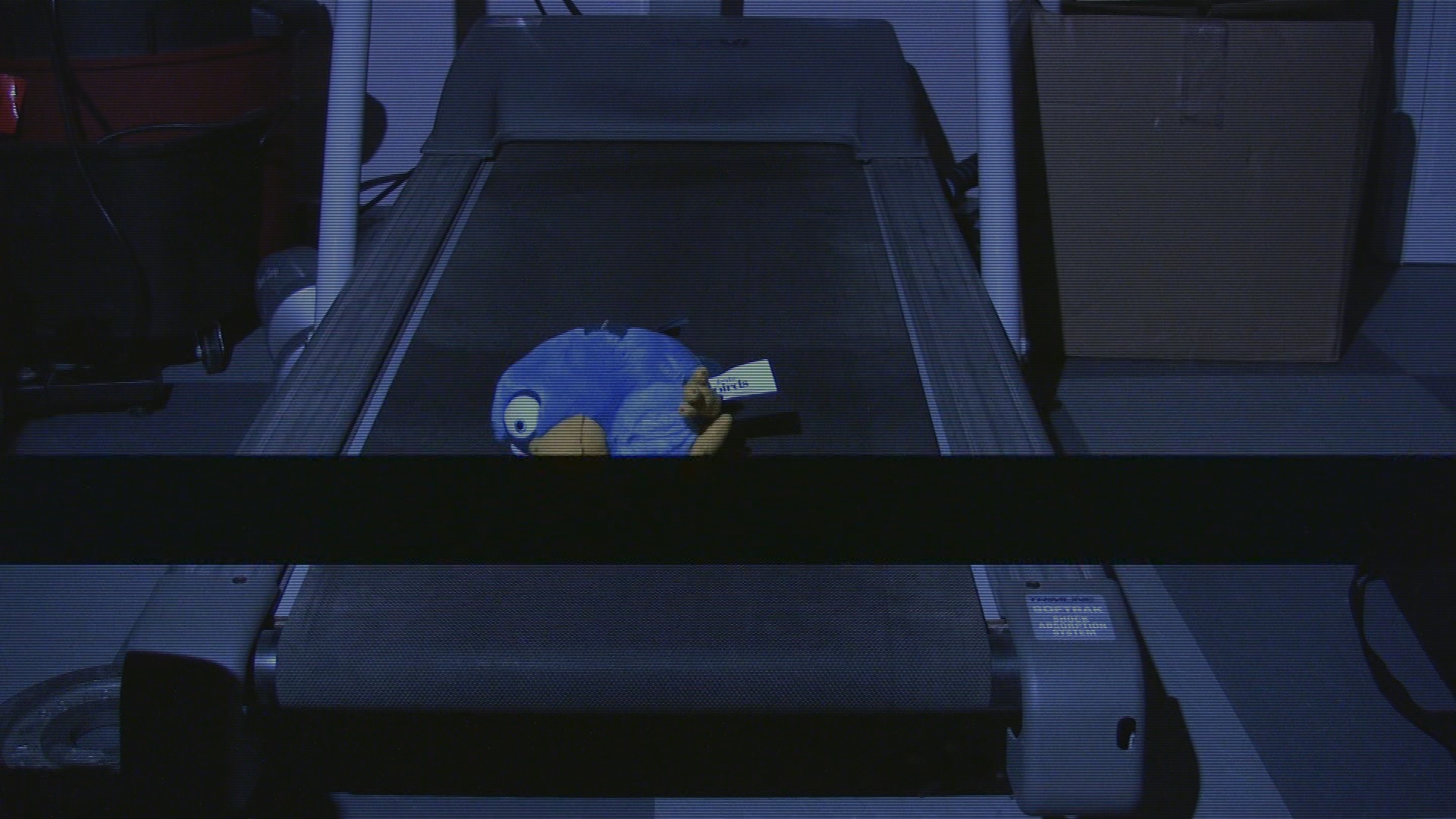

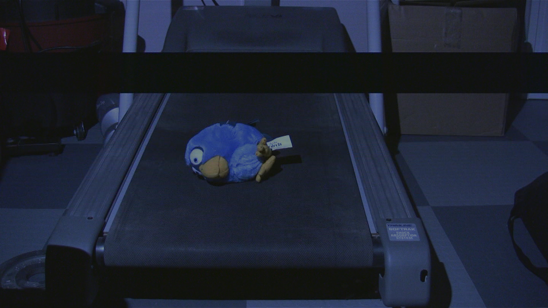

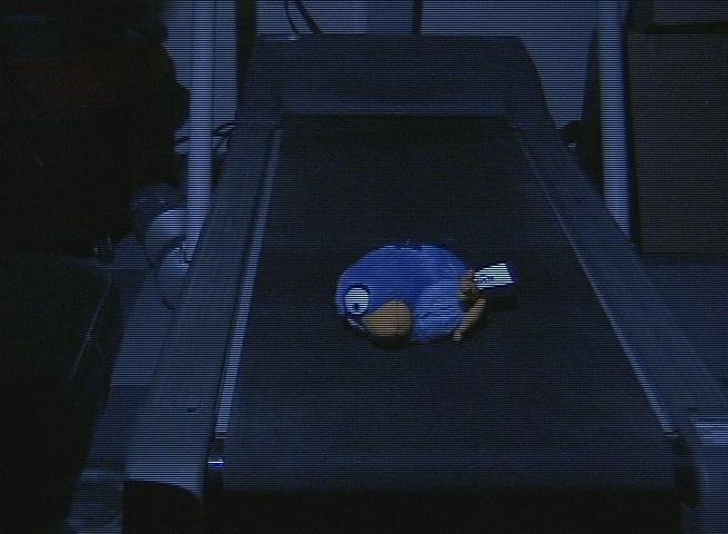

As promised, here are frames from an HV20 showing what happens
when recording a strobe light (my rebel XT flash) with a rolling shutter.
For comparison, I recorded the same frames with an Elura, which is a
CCD camera and uses a different shutter system. You can see the Elura
records a clean full frame of strobe exposure. The HV20 cannot do this.
It seems this is an annoying limitation of CMOS camcorders for now. That said, however, I am so thrilled with capabilities of this camera, and see Canon bringing more of its larger frame Cmos technology to consumer videography.

One simple question. At what shutter speed was the video with the black bars taken ? It looks like it is probably the first shutter faster than the speed at which there is no problem (if you are using a flash).
Please try again with faster shutter (larger black bar) and slower shutter (no bar I hope).

For clarification, in the currently posted images, the Elura's shutter speed was set to 1/60.
The HV20 was 1/48 in 24P mode. The flash was in pre-flash mode (red-eye reduction) where it flicker-strobes for about eight video frames.
All of the Elura frames were cleanly illuminated by the strobe, while most of the HV20 frames had the black bar at various frame heights.

UGH... I've seen "rolling shutter" on an HC1 (flash on top and bottom of consecutive frames, only really noticeable if you're scrolling frame by frame), and the stretch/tilt if you move your cam around too fast...
BUT those black bars are horrid! What settings was the HV20 at to get that? It looks more like a bad head clog than "rs" - I'm sure it isn't, but it would make any footage unusable - not a good wedding camera if this is how the Canon handles flash... can't imagine a glitch like this got past engineering.
How many frames are affected? Just one, or several? IOW, in normal playback does this show, or just frame by frame?
