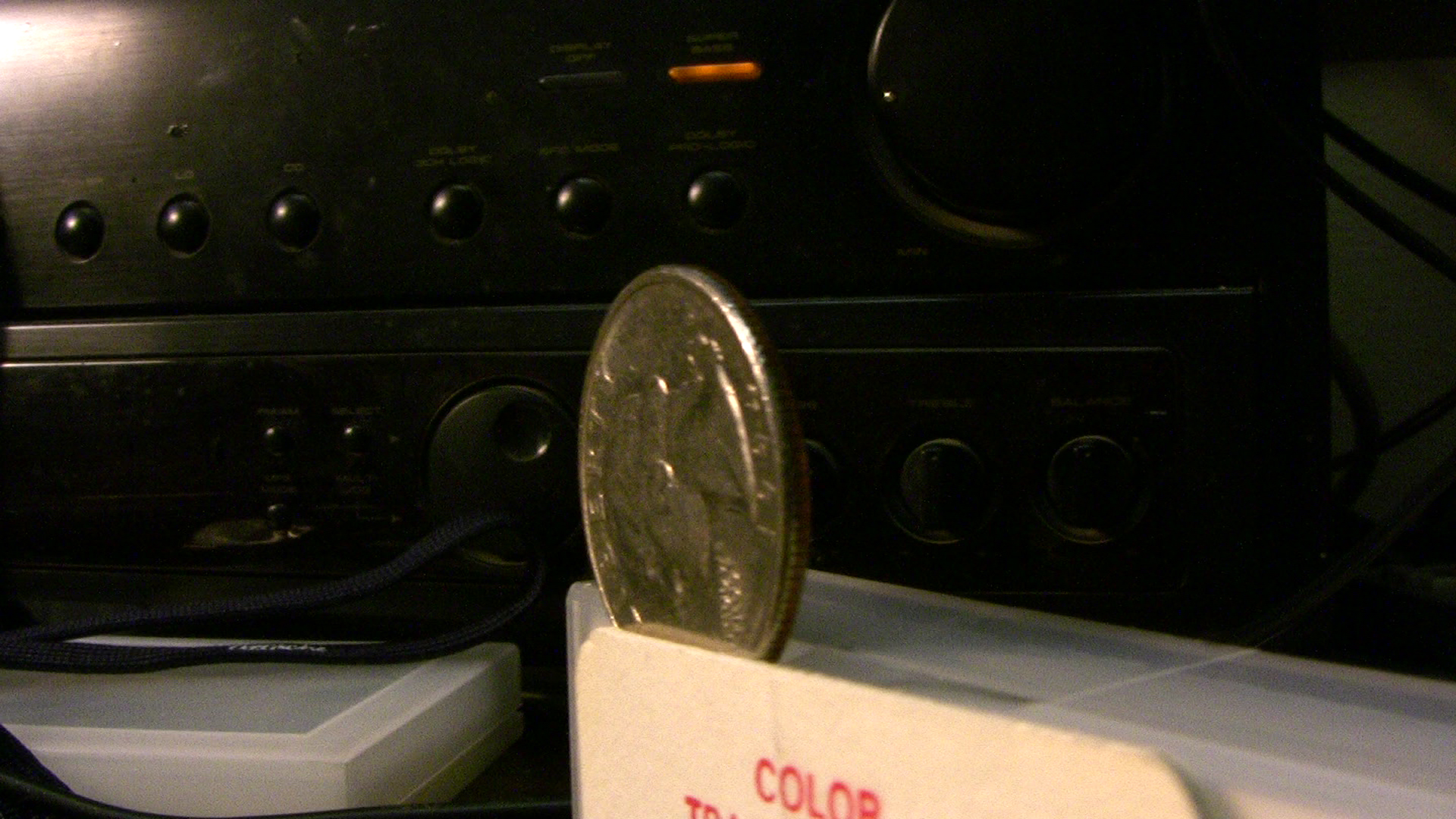

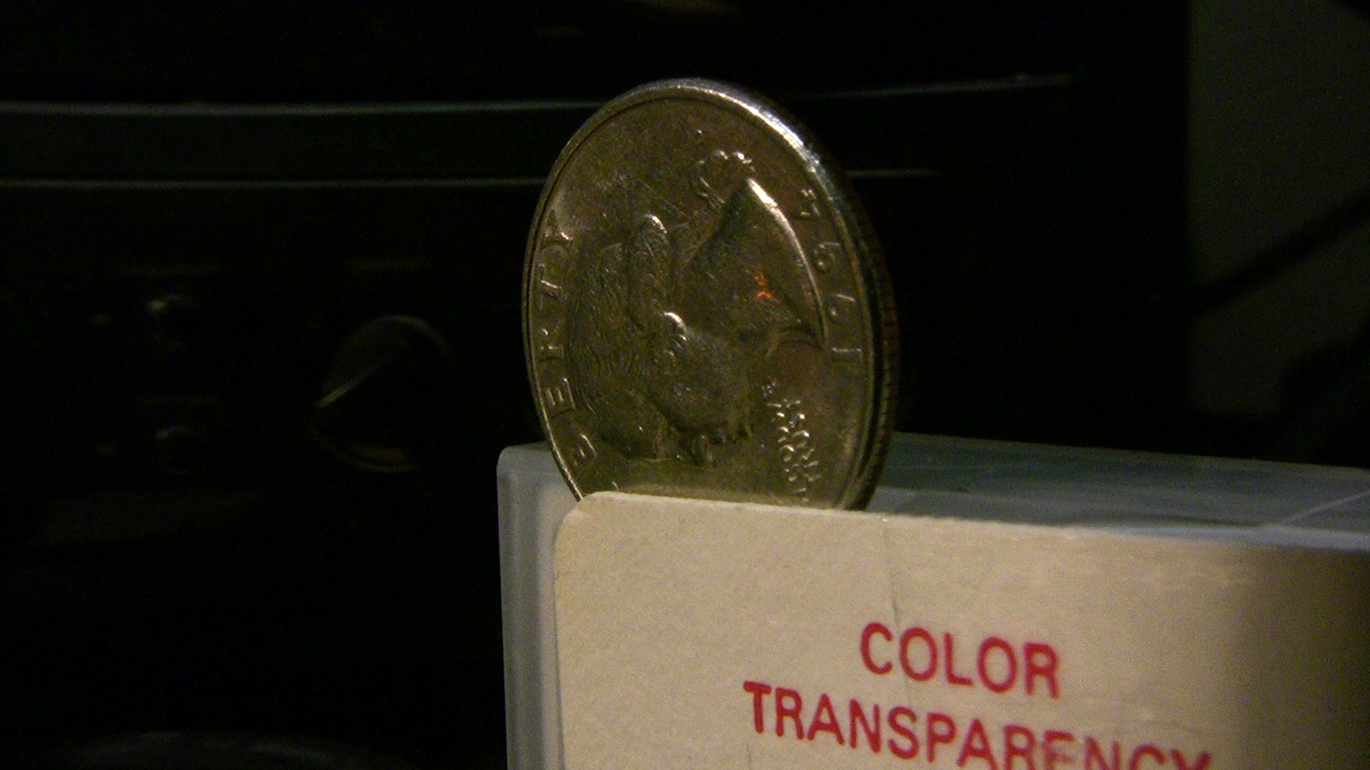

Joey:
Here are two coin shots at F8. The lighting isn't that great, just shot on my desk. One is at wide angle, the second is wide with an achromat attached. To allow closer focusing. It is the Cinevate achromat. I've got to get a mini SD to take photos, so these are grabs from live video shot, converted from tif to jpg.
HV20 Aperture question-coinclosewide.jpg   HV20 Aperture question-coinclosewithachromat.jpg

Thanks Chis
Thanks Chis those pictures helped alot. Is the achromat like a close up filter ?
My videos
http://vimeo.com/user277672
Joey Atilano is offline   Reply With Quote
Old April 9th, 2007, 04:03 PM   #9
Location: Elk Grove CA
Posts: 4,894
Yes, except it had two elements and is multicoated to reduce aberations. About $250.00 at Cinevate.com
