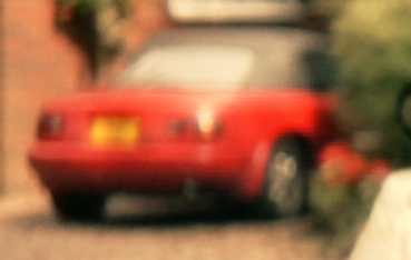

Hiya,
you see the HDV shot in the photoshop file - look round the eyes and there is horizontal lines in the curve that seem like compression.
this is exactly what im finding when i convert my hdv DOF adapter footage with hv20 to computer... (actually even without the DOF)
on the tv it looks great no banding, but once its in the computer everything bright red has this slight horizontal banding that looks like jpeg/mpeg compression, is it something im doing wrong? ive tried tests with cineform and raw m2t files but both the same... im sure it never used to do this, the television i linked it up to with hdmi from the camera has no enhancements turned on and raw footage looks nice, with no red problems.
pic attached is from a fullframe grab its something in the background out of focus but open it 100% and you can see the red lines im talking about, hv20 problem?.
any ideas?
cheers
Oli
