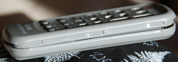

1. Shows the lugs on the remote casing. Flat blade driver and a bit of patience and off they come.

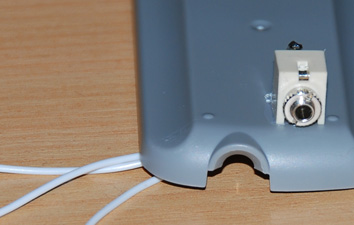

2. Shows the external electrical connector, with the LED having the section of lead removed and the holes drilled into the bottom casing for the wires.

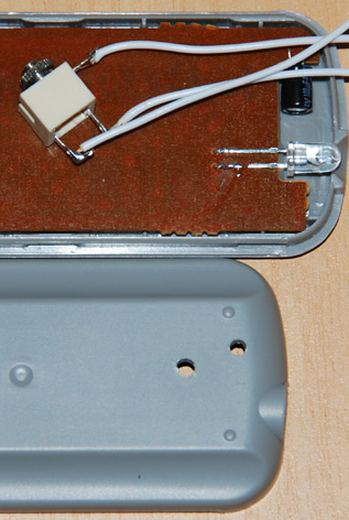

3. This shows the external connector cemented to the casing with the attachment wires trailing.

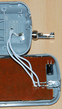

4. This is the attached wires onto the LED. There is, most definately, a gap between those two wires on the positive feed to the LED.

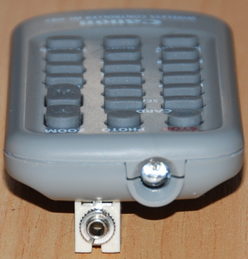

5. This is the finished, re - assembled remote. It sits nicely on the external connector. I'm still working on how, exactly, I'm going to attach it to whatever on the jib/ boom.

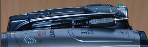

7. Not easy to see as it's all black - the cable from the IR sender to the plug mounted on the top of the camera. NOT taping the tape drive door shut proved to be a bit of a worry but I got there. The plug is out of eye's way and shouldn't interfere with the operation of the "hot shoe" if it's being used.

Chris, on one side of the remote's LED you have two wires tapped (is one ground?). Which wire goes to what side of the phono plug, or does the +/- matter? Do you have matching pictures of the phono plug to the "remote" LED?

I agree the piccies aren't exactly self explanatory - so here goes. Once you've got your remote apart, if you flip out the circuit board and turn it over to the non - track side, you have just the led and the battery terminals. Now, if you look at the board with the led up and the terminals down (at the bottom) the r/h lead of the led is the positive (+) feed, the l/h lead is ground (-).
I cut a (very) small chunk out of the r/h (+) lead to give me a (+) feed and (+) return. The l/h (-) wire goes to the "barrel" of the socket, which always connects to the shaft of the plug, which connects to the "barrel" of the in - line socket etc etc.
The (+) feed connects to the "tip" connector in the socket, which connects EITHER with the (+) return to the remote itself, OR the "tip" of the inserted plug and thus eventually the "on - camera" sender. Thus the (+) feed always connects to the "tip" all the way down the line.
In case you can't see what is connected to what in the socket, take the naked socket and a naked plug. Insert plug fully into socket and measure with a multimetre which connector on the socket is now connected to the tip of the plug. Whichever of the two possibles it is gets the (+) feed from the led, the other one is the (+) return and gets the second wire from the r/h led lead.
I don't actually have a piccie of the wiring on the remote sender led. However, if you check out the original remote led carefully, you will notice that internally the two leads that go into the resin are not identical. The ground (-) lead broadens out to quite a solid platform on which is mounted the led chip itself. The (+) lead is much smaller and has a very fine, almost invisible, "flying wire" from it's end to the chip. All led's are broadly identicle in this respect so identifying which way 'round to connect them is pretty simple.
Ergo, (+) = tip, (-) = shaft. Can't go wrong !
