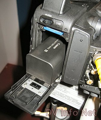

Old September 8th, 2006, 07:27 PM   #13
Posts: 23,178
Battery compartment revealed
Here's what's behind the battery compartment door. The BP-950G has been pulled halfway out. The larger BP-970G fits easily. Note the SD card slot just above.
Canon XH batteries / battery thread-xhbatt.jpg
Search DV Info Net for quick answers | The best in the business: DV Info Net Sponsors | ...Tuesday is Soylent Green Day!
Old September 8th, 2006, 08:56 PM   #14
Posts: 41
wow.
your pic?
Dean Digamon is offline   Reply With Quote
Old September 9th, 2006, 01:54 AM   #15
Posts: 23,178
My pic but sadly not my cam.
