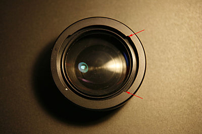

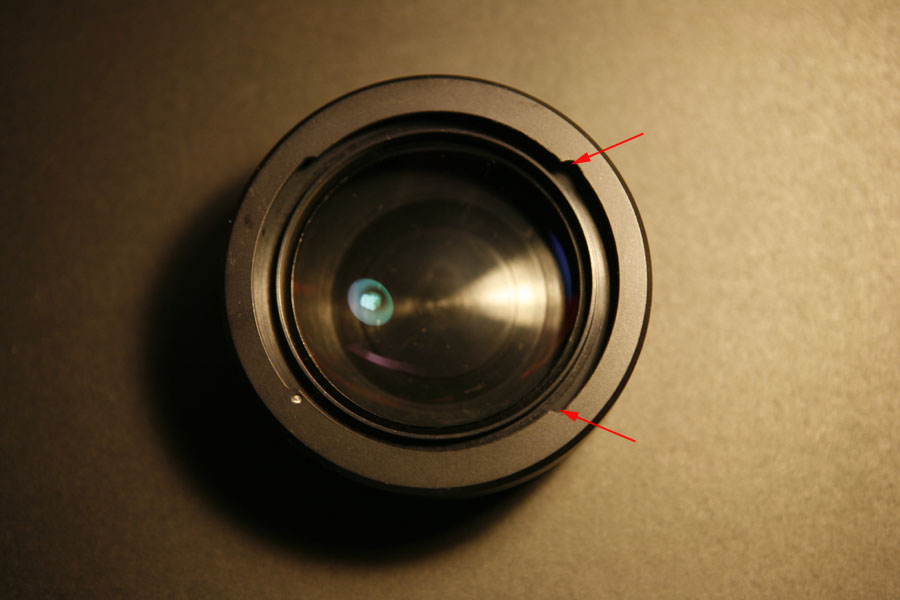

It worked this time - thanks Chris.
The first picture shows the points at which the opening in the adapter had to be widened. Note: it shows reassembled adapter.

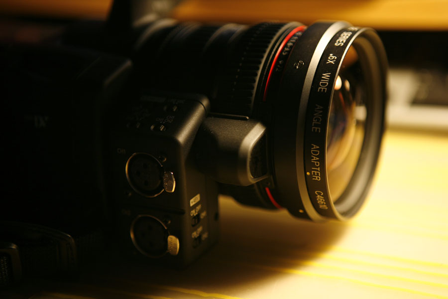

Second picture: just satisfaction :)
