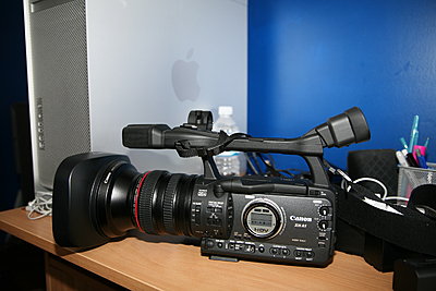

Received camera and wide converter... Spider Brace or Canon SBR-1000
Haven't had much time to play around with it yet, but it is heavy. So what shoulder mount do you have for yours?
