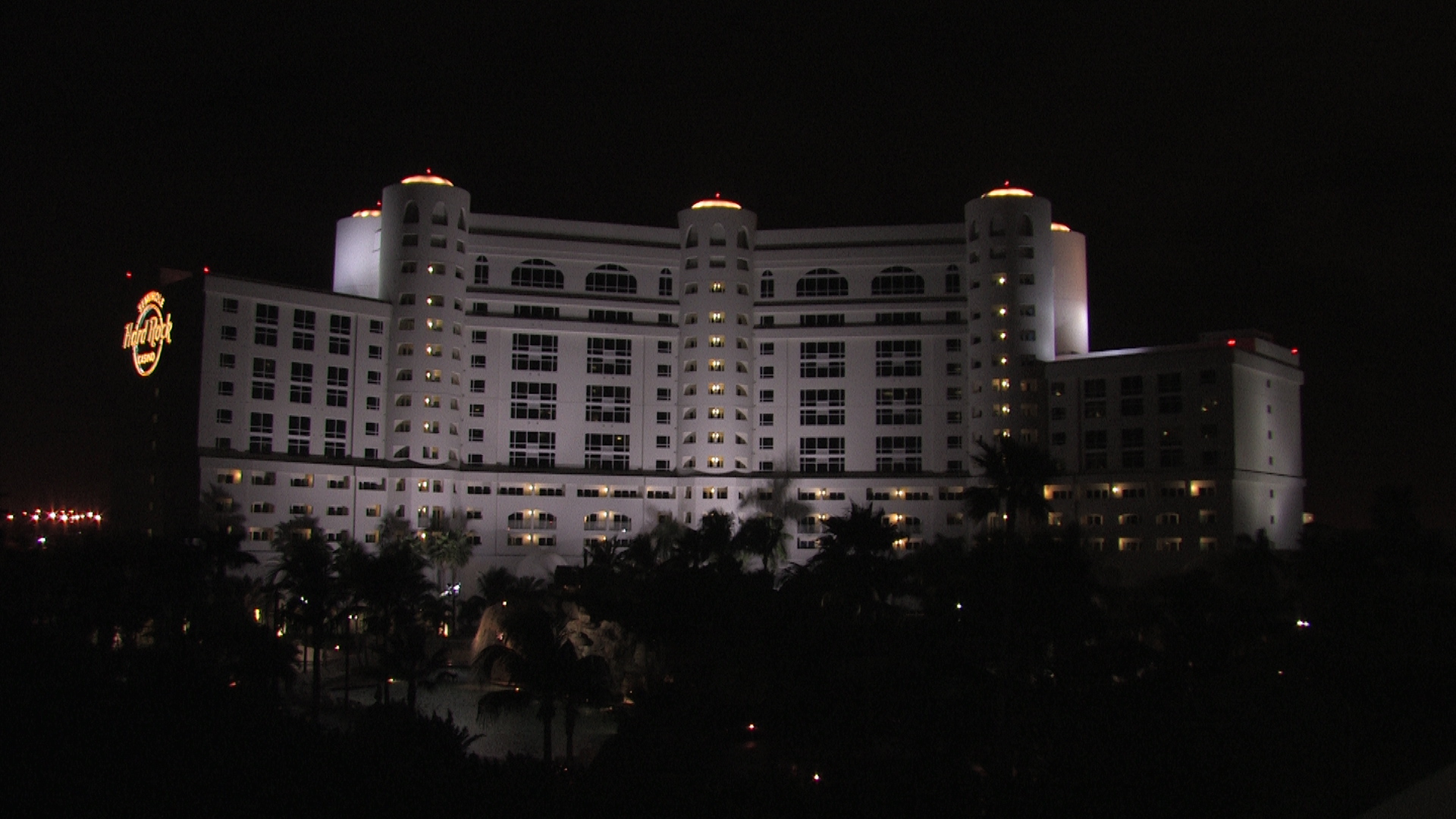

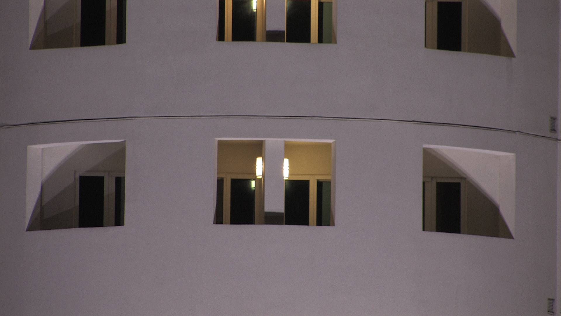

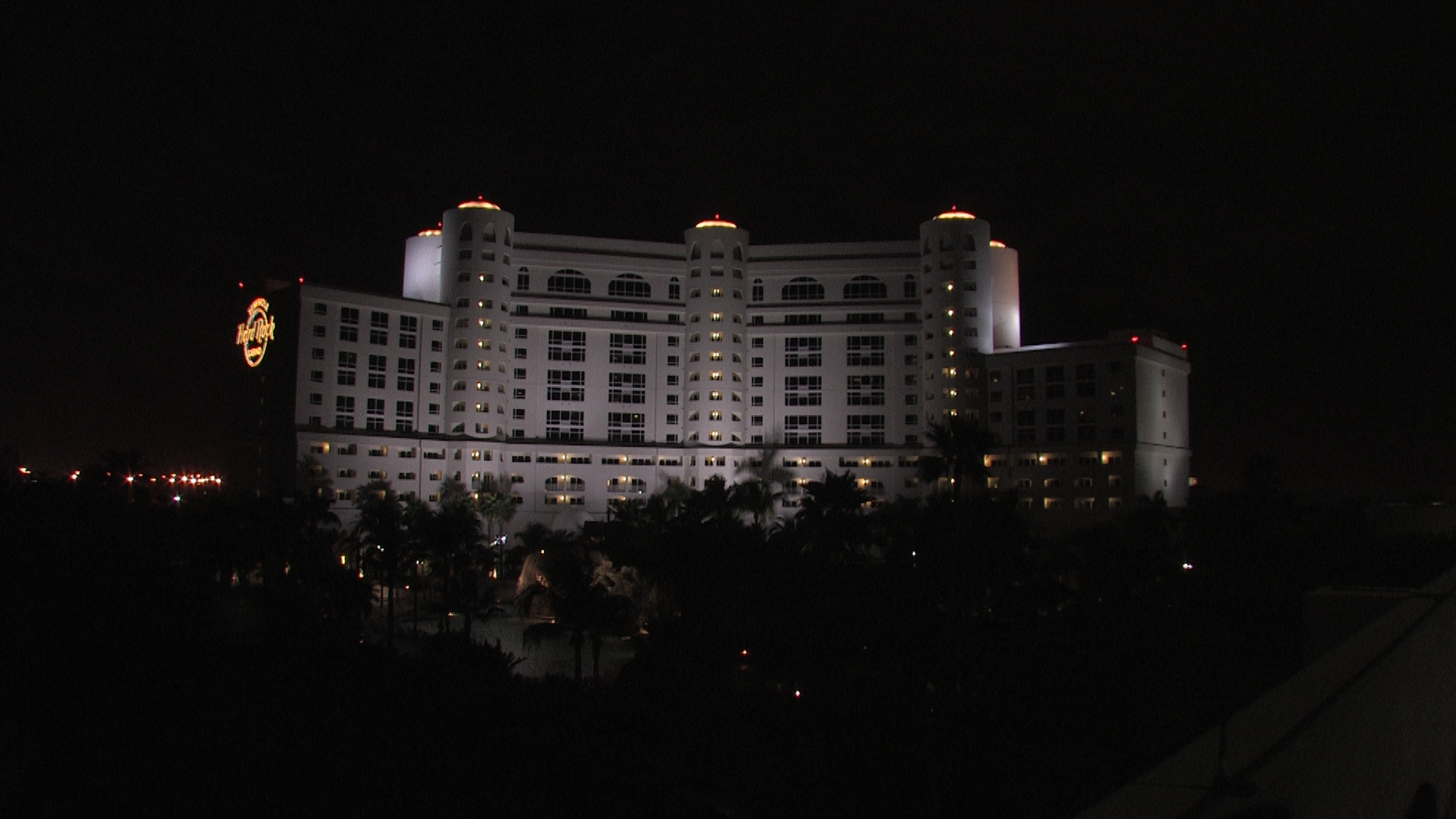

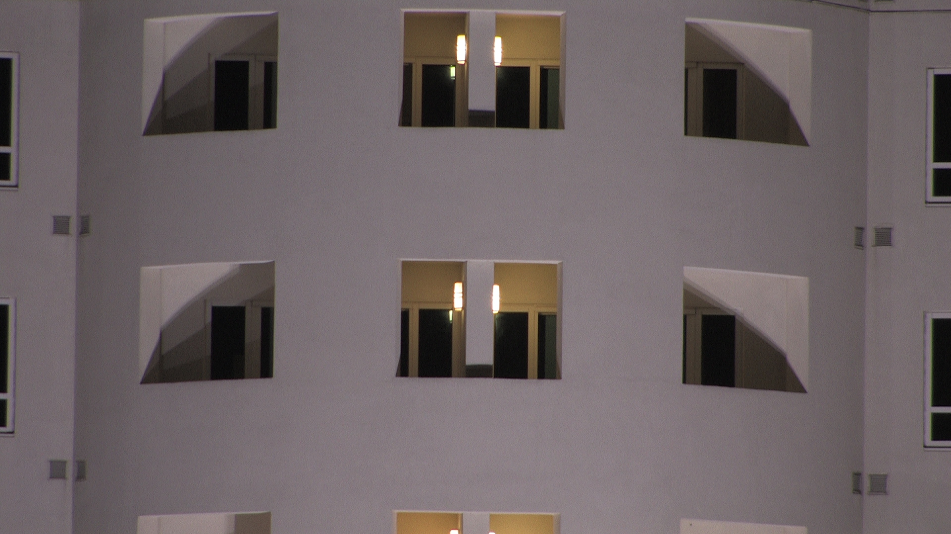

Field of View comparisons: with and without WA adapter
Canon XH with and without the WD-H72 0.8x wide angle adapter. All of these still photos were shot at f/3.7 in order to maintain consistency throughout the spread; the XL H1 was also part of this series and the max. aperture on its 20x lens at full tele is f/3.5, so that was my baseline for everything. Zero db gain. Shutter 1/30th. Subject is the Seminole Hard Rock in Hollywood, Florida. Full wide and full telephoto with both XL HD lenses, the 20x and 6x. Click thumbnails to see the full-size versions.

Field of View comparisons: with and without WA adapter-xhx20wide.jpg   Field of View comparisons: with and without WA adapter-xhx20tele.jpg
Field of View comparisons: with and without WA adapter-xhwawide.jpg   Field of View comparisons: with and without WA adapter-xhwatele.jpg
